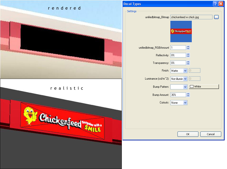

I'm having an issue where I go to render views and the decal's that I have applied render as black, yet the JPG file information is all there under the Decal type.
 Also when I go to realistic view (using Revit2011) the decal's image appears, so it only appears as black when rendered.

Hmm. Didn't fix the problem. If it helps, It worked when I first rendered the decal, the JPG was displayed. But then I placed more than one of the decal and added new decals and then they appeared black. So i deleted all the decals and loaded the one decal again and it still renders as black.
 I'm not an expert on rendering, so I'll post all the decal type info to see if there are any conflicting things that could result in it rendering black.
the Bitmap is a jpg so no issues there.
unifiedbitmap_RGBAmount = 1       Reflectivity = 0%                Transparency = 0%           Finish = Matte                    Luminance= not illuminated           Bump Pattern = (BLANK)      Bump Amount = 30%       Cutouts = None

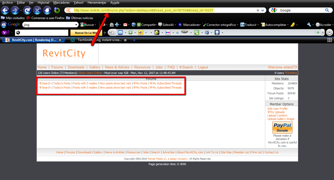

Maybe this is the problem: www.revitcity.com/forums.php?action=deletepost&thread_post_id=58760&thread_id=16237

YES it work: http://screencast.com/t/MmU2ZmFjMz

Yeah... sorry Typhoon. No can see... you could copy and paste the whole thread to this one Winking
 BUT from what I did see from your screen shot, I don't think that that is my issue because it still shows up in realistic mode as the proper JPG in the correct position. So the Decal is definitely placed in the correct position as shown below.
