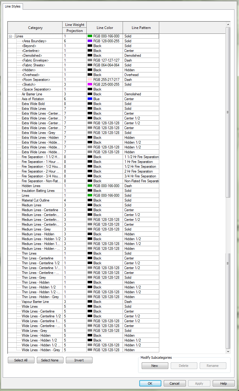

you can change the 'Lines' line type colour under manage tab > additional settings > line styles and then expand the + and go down to 'Lines'

Unfortunately, nothing would work. It is still green

This is a list of all my line styles and their properties. Changing the 'Lines' at the top which shows as green doesnt do anything. There is a default 'Lines' category half way down that is green that changes. If that doesnt work then unless you post your project it is difficult to determine the issue.
