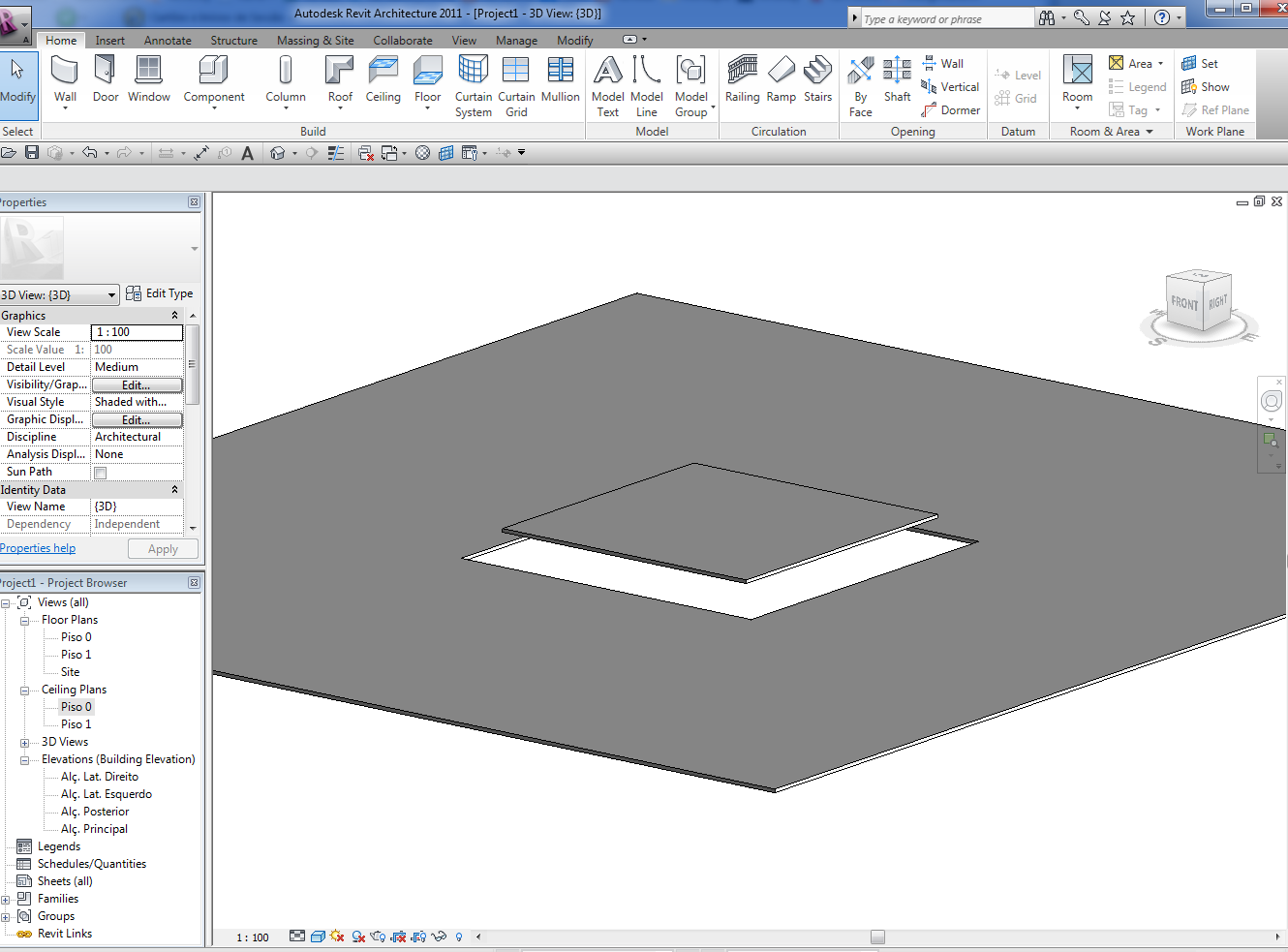

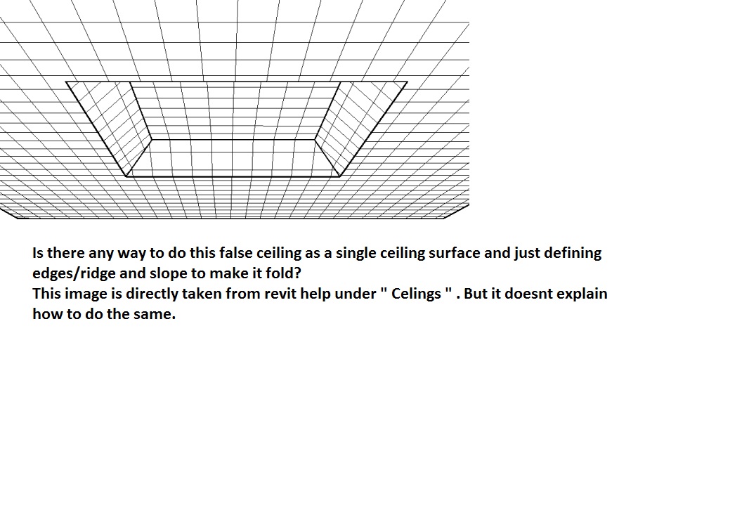

Please see the image attached.  I am not able to create a Ceiling the way it appears using the slope property. the Slope property explantion is very confusing for where it talks about Defining slope at constant heights & slope arrow . I tried to understand what it does by experimenting but i only ended up with an overall slope(applied to the entire surface) it doesnt let me slope specific parts of it.
Sat, Sep 18, 2010 at 4:23:15 AM | Folded surface False ceiling / Issues with Sloped False ceiling
Joined: Tue, May 22, 2007
5921 Posts
4 Stars: 205 Votes

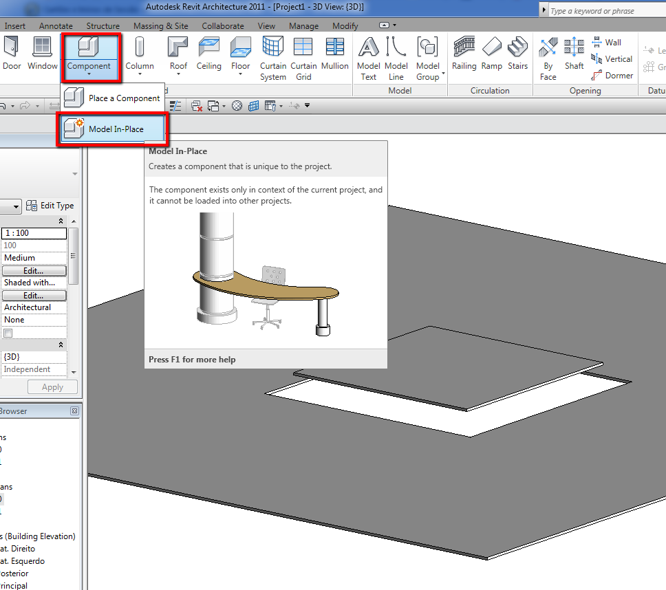

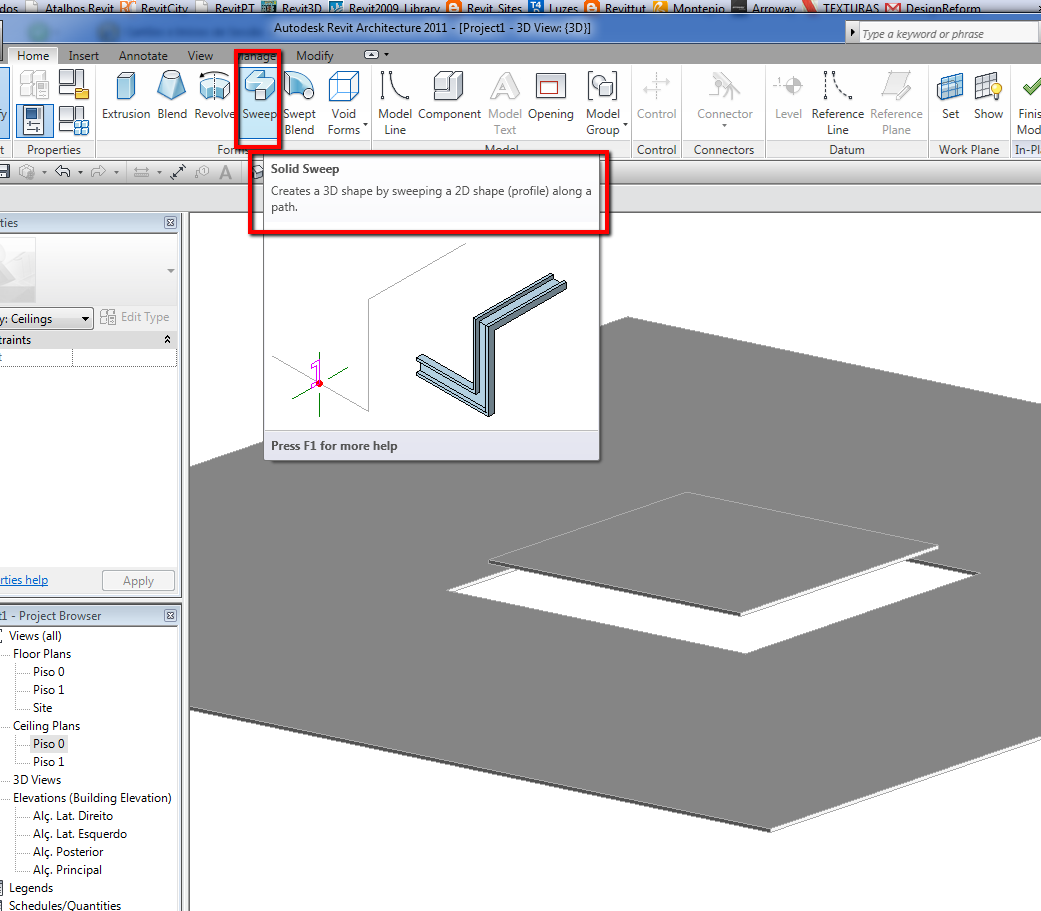

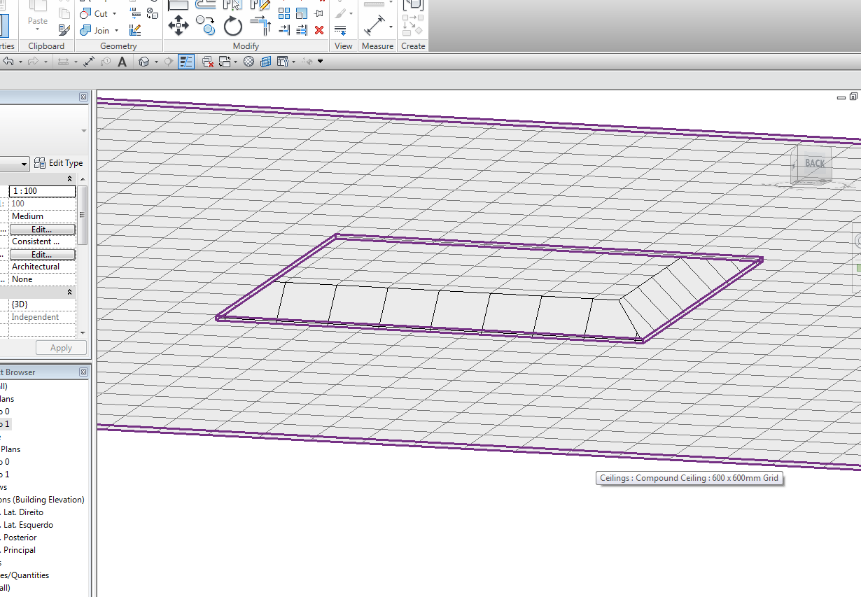

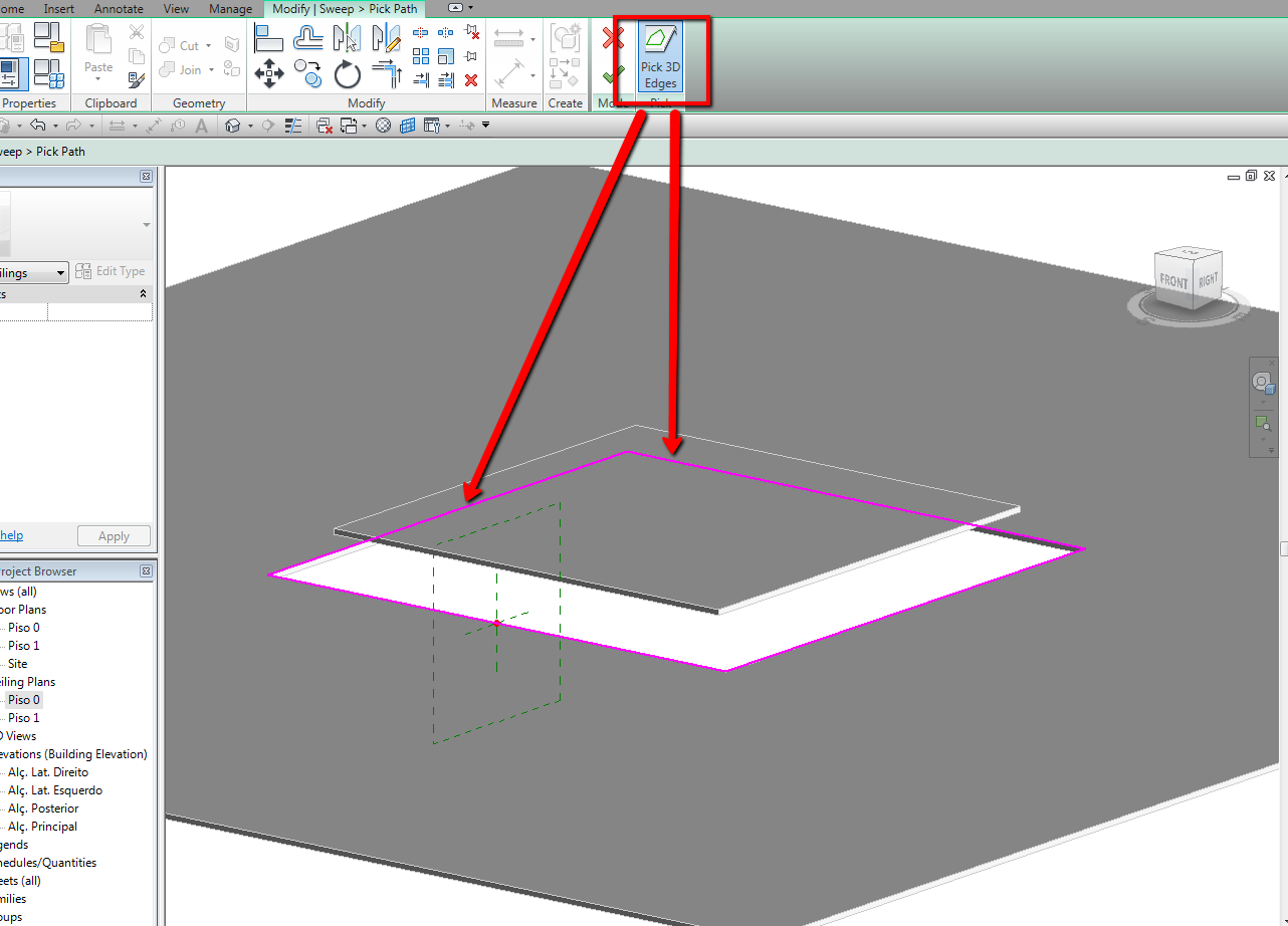

First create the two ceilings (flat ceilings) first image, then to create that slope part just use the "In-Place" - second image and choose the category "Ceilings", select "Solid Sweep" -  thirth image then use the "Pick Path" and click at the edges of the ceiling - fourth image, then create the profile like you want and Done.

Is there any way to do it using the system family properties and not as in place mass?
Sat, Sep 18, 2010 at 5:12:51 AM | Folded surface False ceiling / Issues with Sloped False ceiling
5921 Posts
4 Stars: 205 Votes
watch the video: http://screencast.com/t/YjMzN2NmYzc
