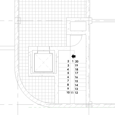

Hello fellow revit users,
I have ben trying to create this stair design, but cant seem to get it right. Can someone please show me how. A screenshot of the appropriate boundry lines and risers would help. I have attached a picture of the outline. Thanks in advance

Gotta run, can't model it, but:
One problem I see is that your boundry makes a complete 360.  The boundry line for riser #1 can't touch #20.  Fake a little gap in there.  1/16th of an inch will do.   Also, make a break in the broundry line at each landing, or else it will attempt to carry the slope through your landings.  This is a pretty doable stair.

Thanks itsmyalterego, it worked!
