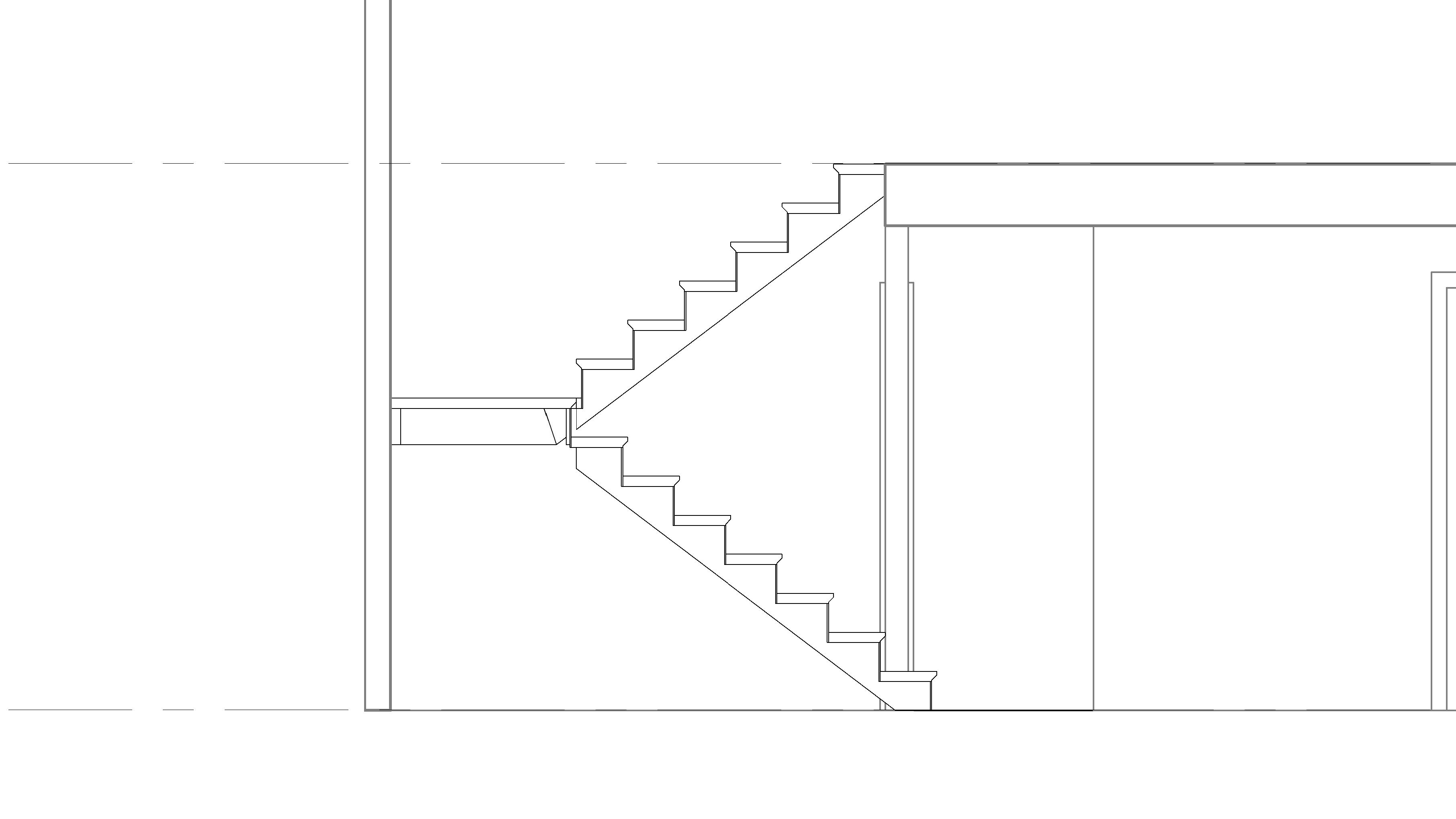

Revit is killing me!  I am drawing a basic stair with a landing and switchback.  Does anyone know how to get the section to look correct? The carriage is not connecting to the landing,  it is just floating in space.  If Revit cannot do these simple things correctly... what is the point!

Fri, Sep 17, 2010 at 1:55:33 PM | Stair to landing connection shown incorrect in section
aozarski
Joined: Fri, Dec 18, 2009
11 Posts
Sorry about the rant.  This program just drives me crazy sometimes.  I do love it sometimesSmile  Please see the attached image.  If I was to show this to a contractor he would think I am incompetent.

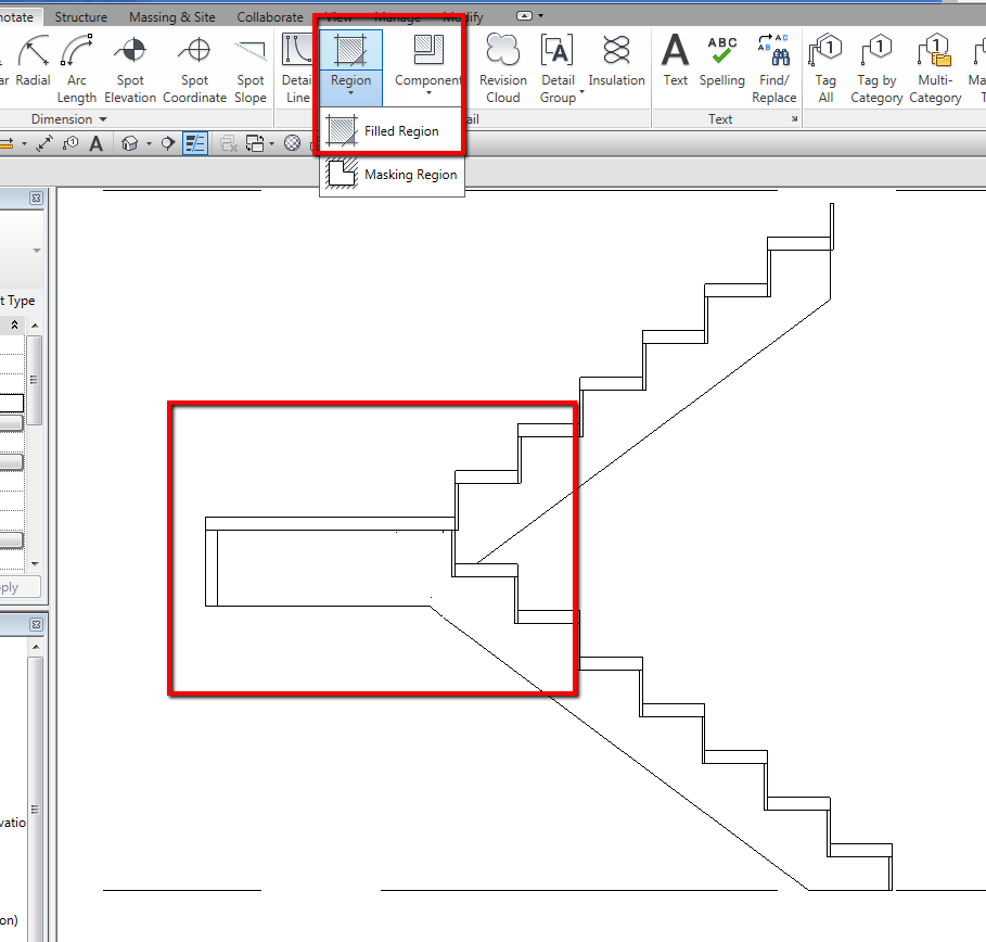

Sat, Sep 18, 2010 at 5:21:35 AM | Stair to landing connection shown incorrect in section
Joined: Tue, May 22, 2007
5921 Posts
4 Stars: 205 Votes
In that section view use the "Filled Region" to clear the problem.
