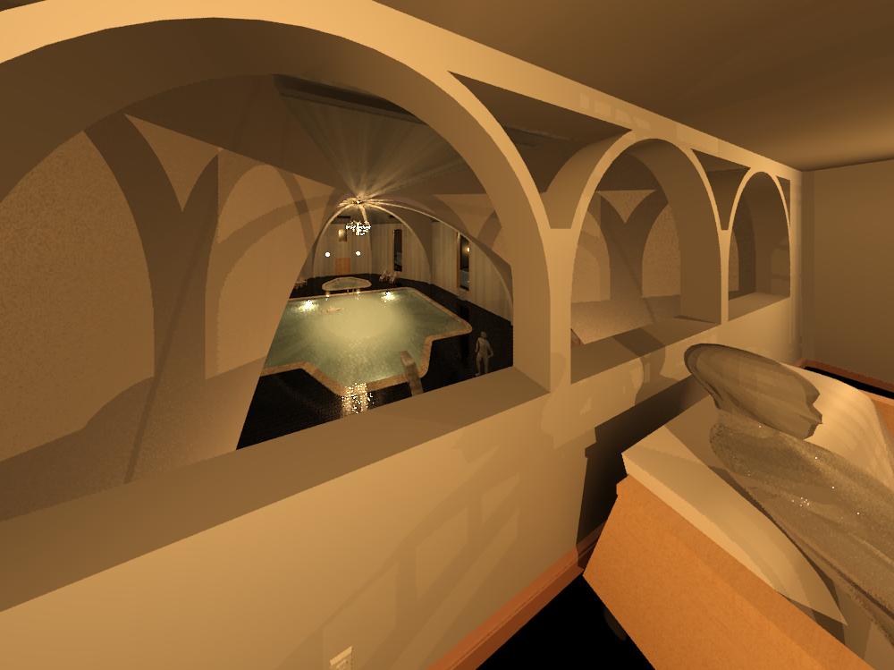

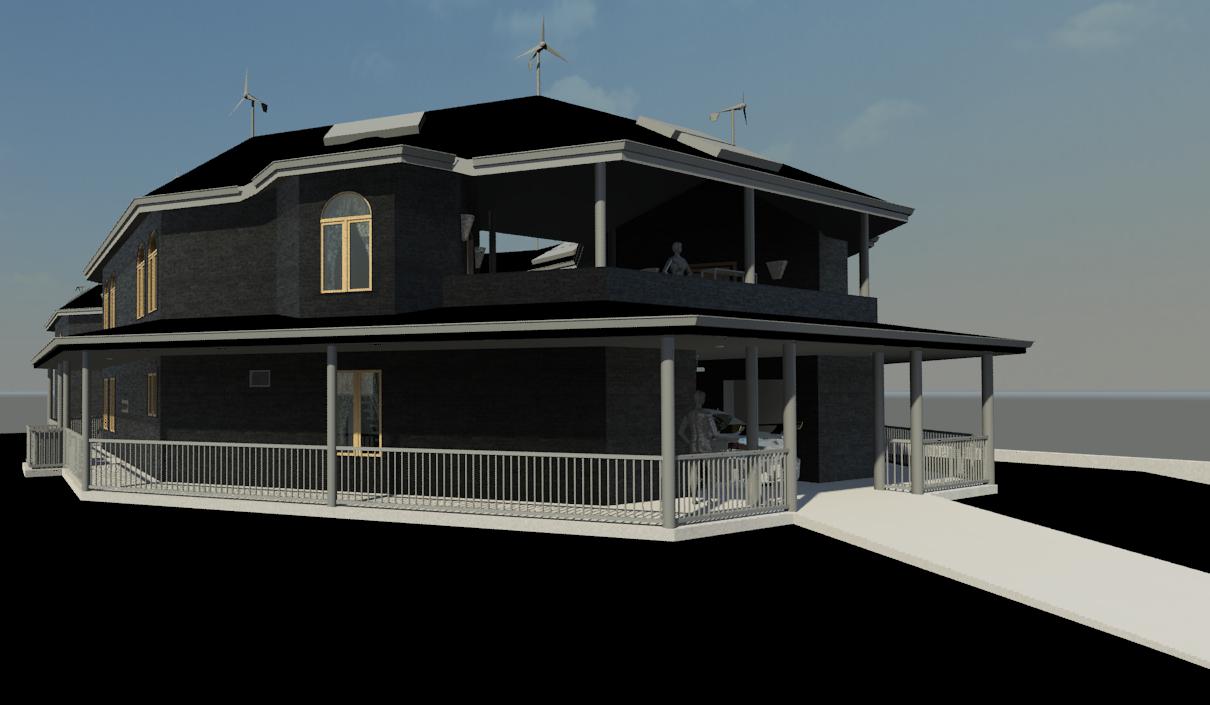

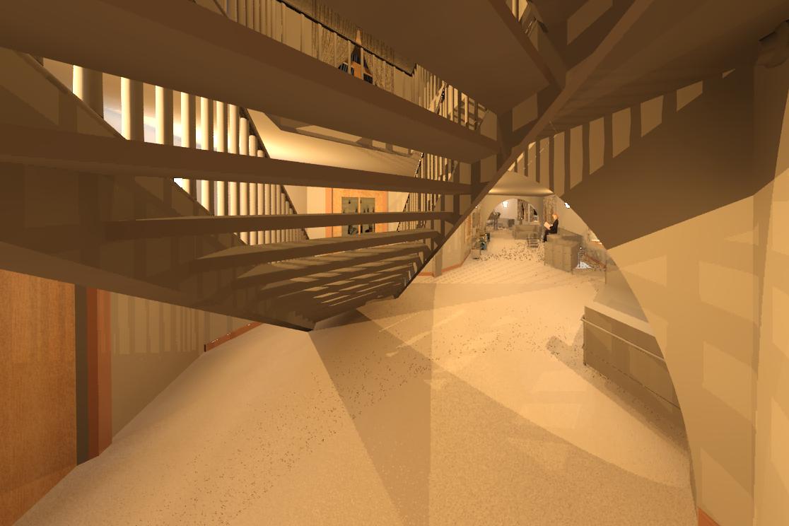

One, is that when I go to render any part of a design, it omits large numbers of images and materials from the objects. The objects themselves all come out either pastel white, looking almost like a bland yogurt, or just replaced with a big black space where the floor or the ground should be. It isn't just the foreign jpg samples that are missing now, either. Its the standard materials package that comes with the software that disappears too.
For example, the first attached picture should have blue carpet below the couch, and terra cotta red tile around the pool. In the second (Living Room) the stair runners, and the funiture should be black, an there should be metal and such in hte TV and coffee table. In the third (House), it should be an ash colored brick house with red solider course around the windows, but in it even the grass in the yard is somehow omitted.

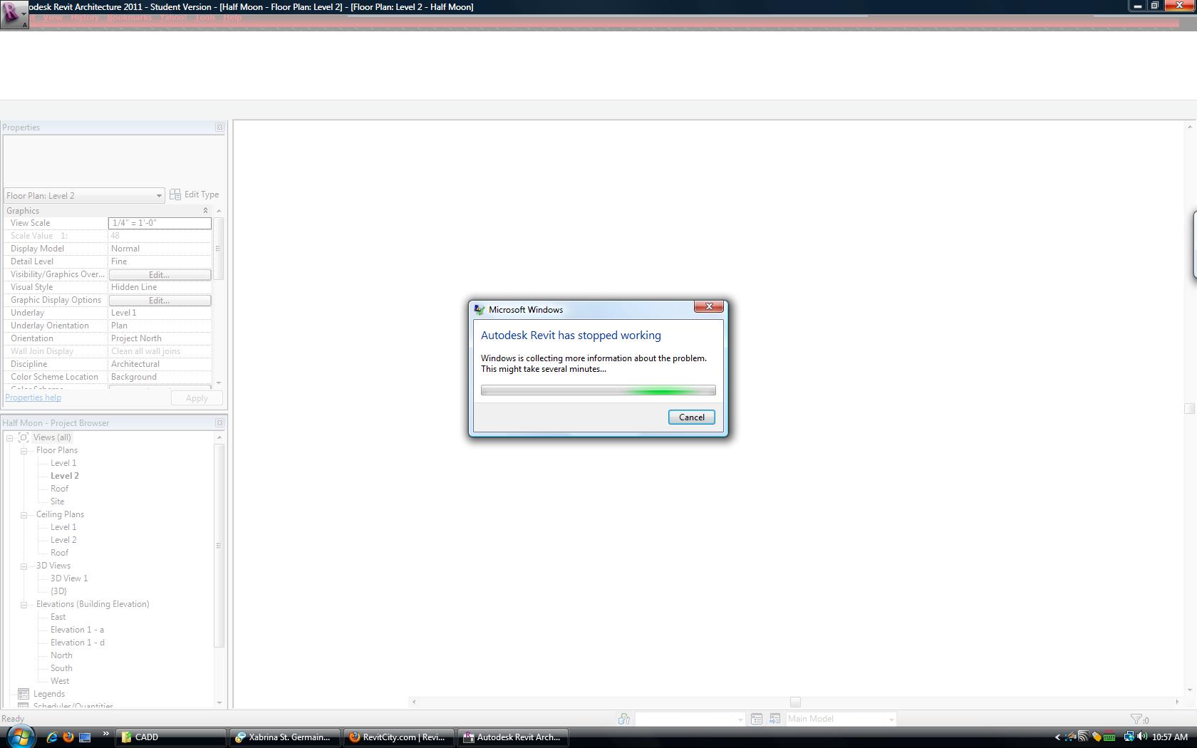

Two: When I try to go in and redirect the material image back to the file, or even when I just try to change anything about any material, the entire program crashes, and shuts down. Usually this happens after I've made the adjustments, hit "ok" and tried to return to the drawing. And, of course, when it crashes, I lose every adjustment I've just made.

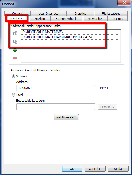

Do you receive the “The following render appearance images are missing:” warning when rendering?
Ensure the windows temp folder is not full, use software like "Ccleaner" to clean those temp files,  check in Option if you have the path in Rendering - Aditional render appearance paths

I found the problem. tablet driver didn't make friends with revit. I just had to disable it, and everything works perfect again :]
so I'm not so crazy material changer :D

You have to go to "task manager" (ctrl+alt+del) then go to services find services button. from the list in the new opened window find "tablet pc input service" double click. than in "start up" menu choose "disabled" and ok. thats all :] hope it will help you too.
