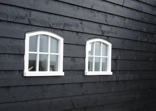

Hello,
in the image you see a wall finish often used. What would be the best way to create this? I did it with a wall sweep, but there's no option to tell the sweep how often to repeat itself. If i add sweeps to the wall by hand, it works okay, but when you create in example a wall which is lower than there are sweeps, you get a warning. So it works, but with a warning. (he can't create the sweeps cause there no wall in that part)
Are there any other ways of drawing this?

Hello Jeroen,
I think the best way is to not draw it for real.
You make a wallfinnish called wood or so and you give it a surface patern.
If you would like it to show in a rendering as in your picture, you can use an bump map to create the depth.
When you make the detail you draw the wooden panels in 2D.
