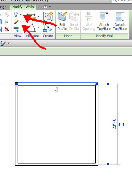

Yup, I have become tired of right clicking so now I just use the ribbon tools instead.
This works on pretty much any element.
Hide Element, Hide Category.
Override by Element, Override by Category.
In addition, section markers in particular have a 'Hide in View Coarser than < >" property.
