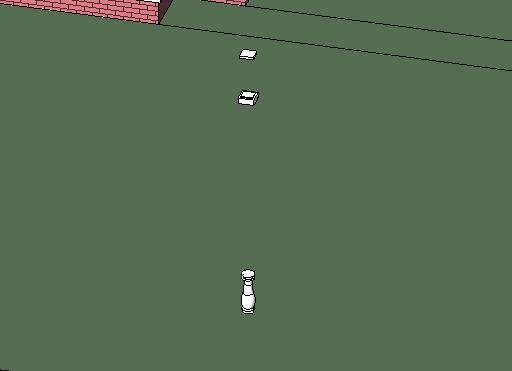

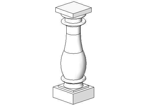

I have modeled a small column for my project. I used the column family template. The base and top are rectangular extrusions and the column body is a revolve with various shapes. It looks fine in the family editor, but when I load it into my project the base and top show up, but the revolve does not. I cannot figure out why this is. I have attached a JPG of the column in 3D view in the family editor.

All the visibilty settings in the family are checked. In all my views in the project the Detail Level is Fine.
I just noticed that the top and base of the column come in at the level I want them inserted. But for some reason the revolve is one level below. In the family editor the top, base, and revolve are lined up as they should be. I have attched a JPG showing this.
BTW, any files I attach are checked by my Exchange email security program, so they should be safe to open.
 Daryl Stockton
Mon, Aug 30, 2010 at 8:10:08 AM | Revolve does not show up
It appears that you ahve answered your own question.  In the family, you constrained the revolve to different references than the extrusions.  Take a look again at how you modeled these elements.
