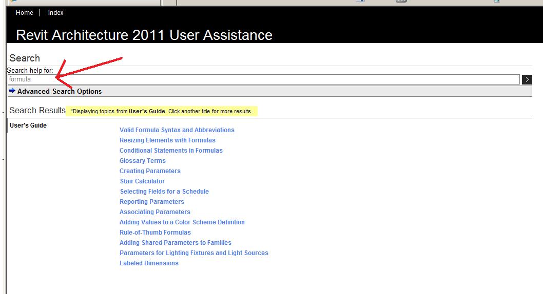

Actually I have no idea what's up with the initial search on the upper right.
BUT after it gives you the 'no results' type the search criteria AGAIN on the left hand side and it works.
Don't ask me what the logic is. See image attached.
