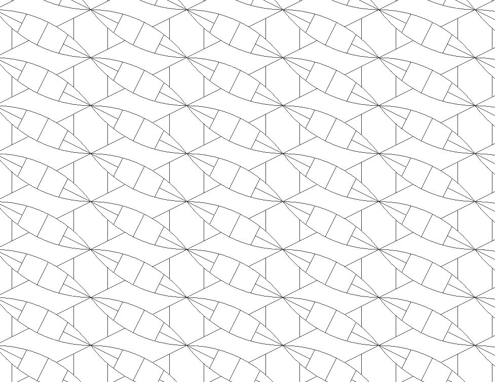

Sat, Jun 27, 2020 at 1:19:53 AM | Custom Hatch Patterns on Revit
#13
dingohot
dingohot Avatar
Joined: Mon, Mar 15, 2010
199 Posts
3.5 Stars: 5 Votes
Here is DynaPAT which can create any pattern you want in Revit directily.
https://plevit1.blogspot.com/2020/06/dynapat-pattern-maker-for-revit-by.html
A sample pat file which is created by DynaPAT is attached.
EnjoyRevit is back. Smile
want more?
You can get more tips at Enjoy Revit
Sat, Jun 27, 2020 at 6:34:35 AM | Custom Hatch Patterns on Revit
#14
19889 Posts
That is a large file!  What does the pattern look like?
Sat, Jun 27, 2020 at 6:41:16 AM | WWHub
#15
dingohot
dingohot Avatar
199 Posts
3.5 Stars: 5 Votes
Quoting WWHub from 2020-06-27 06:34:35
This is it.
want more?
