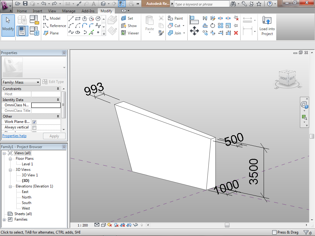

in conceptual mass family .

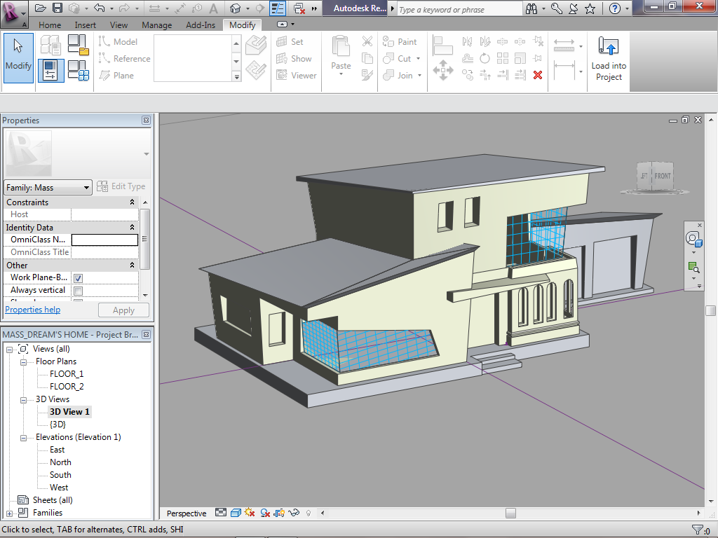

This is home model  with twisted wall
A example wall

Thu, Aug 26, 2010 at 10:11:23 PM | Massing

Thu, Aug 26, 2010 at 10:33:06 PM | Massing
trandung
Joined: Mon, Jun 9, 2008
72 Posts
I understood this one .
Now I like to create style wall ( same picture) with parameter.
 mass should be conceptual or adaptive component.

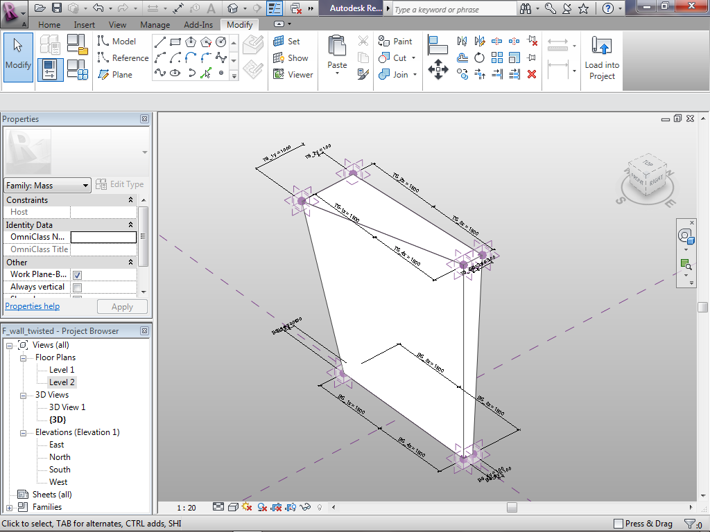

I just created a family twisted wall with paramater .
It can sketch 8 points with x-y .
There are way more compact?!

Do you often use that kind of "Walls" in your projects or you only need for that particular project? because what i see here, you can create that with a simple "Solid Blend", i really like the conceptual mass and the new Adaptive components in Revit 2011, it's a very usefull tool, if you want to learn more about that, check this blog from ZACH KRON: http://buildz.blogspot.com/

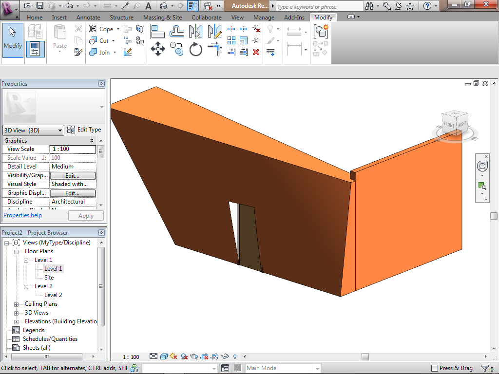

I used to read the blog. very interesting about the instructions for creating all kinds of mass.My job often makes the individual house design, so I like to create tools to make quick schemes.Is there a way to draw a twisted sort of like a wall common wall in Revit ?
