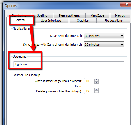

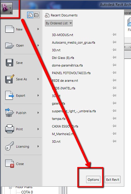

Hello,
On Revit Arch. 2011 how do I change my username to someone else.  This is in order to be able to relinquish worksets from a former employee.?
Wed, Aug 25, 2010 at 1:16:35 PM | username change?
Joined: Tue, May 22, 2007
5921 Posts
4 Stars: 205 Votes
Options > General > username
