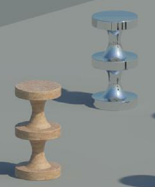

I am trying to make a stool in a family
it looks like
http://4.bp.blogspot.com/_jn-PytY4j7g/S5wGkTDwKPI/AAAAAAAAChU/D0iGSTkcCmY/s1600-h/krukjes500x600.jpg
I get the 2 round flat pieces but how do I make the curved part between?
Please remember I am a complete newb and any help is appreciated. Thanks

You can make this in one piece using a revole. Have a look at the attached file as a guide.

This is an easy one so rather than to explain I just made a quick video.
My 30" high Stool may be a little taller than the actual so you can adjust that as required.
See link below.
