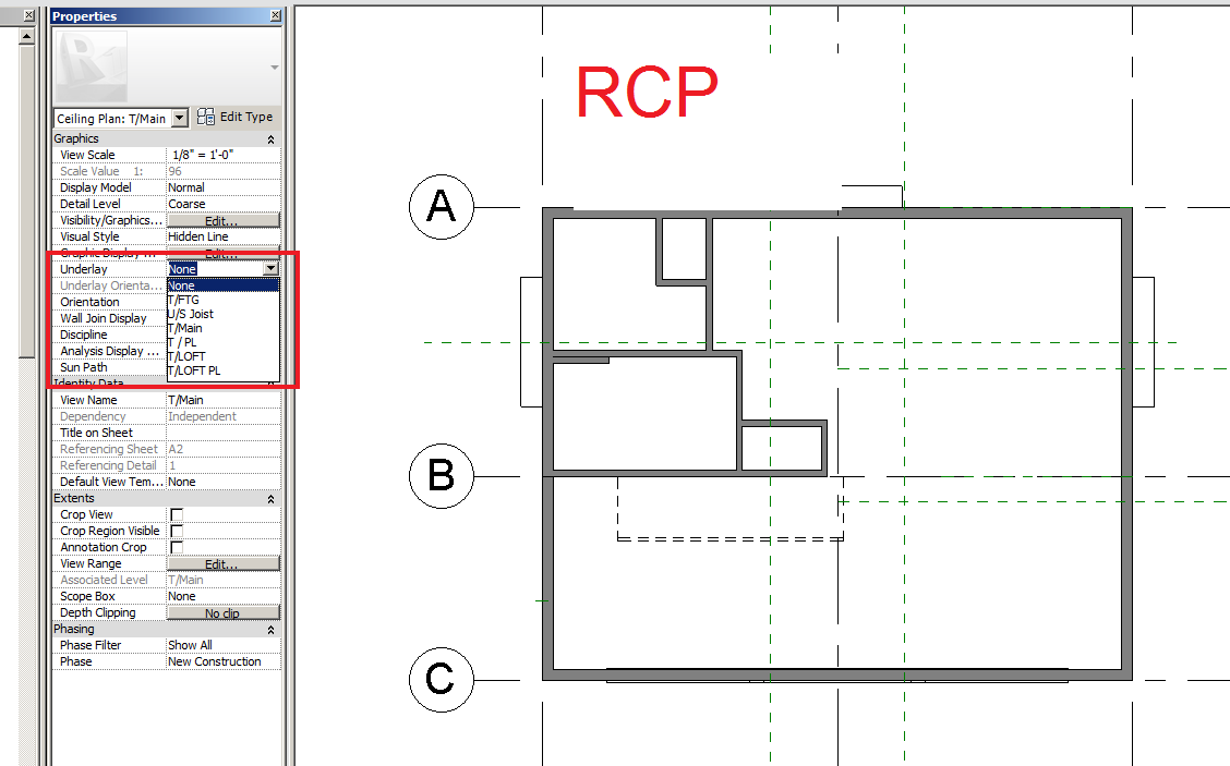

In a sheet how do I show both the Reflected Ceiling Plan and the Refelcted Floor Plan in the same view? In order for a Fire Suppression design and Fire Alarm Layout. We need to show both RCP and RFP on the same sheet. We are doing this in Revit MEP 2011.

Create the RCP then 'underlay' the regular floor plan? The underlay field is a 'property' of the view.

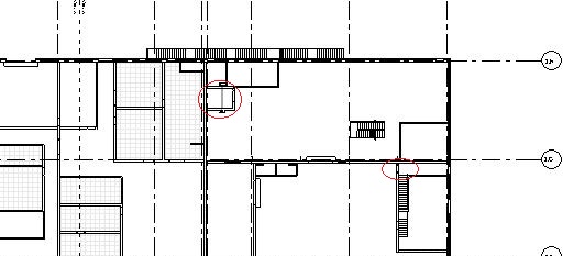

It helps but we have an issue with the view range. It does not show everything from the RFP, missing doors and Elevators.
We've adjusted the view range and were able to get the stairs but still missing doors and elevators as marked in attached file.

Maybe use a 'Plan Region' in those locations.
A 'plan region' allows you to created nested view ranges within the plan. Very handi for those hard to reach places.
