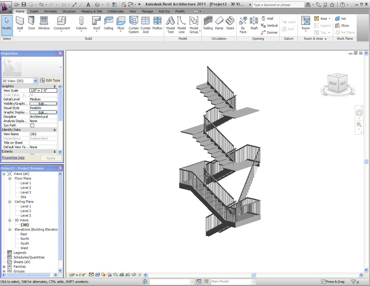

The railing seems to uncooperative after the 20' mark. There is a problem in the "chain" of the railing i guess?. Has anyone had this problem/know how to fix it. Answers would be greatly appreciated!
Attached is a pictured showing the problem .
Thanks a lot, Jonathan

2 way i know how, (1) delete the obscure railing and redraw the railing line on the landing it is supposed to go, or (2) select host and click on the landing. Give them a try and see what happens
