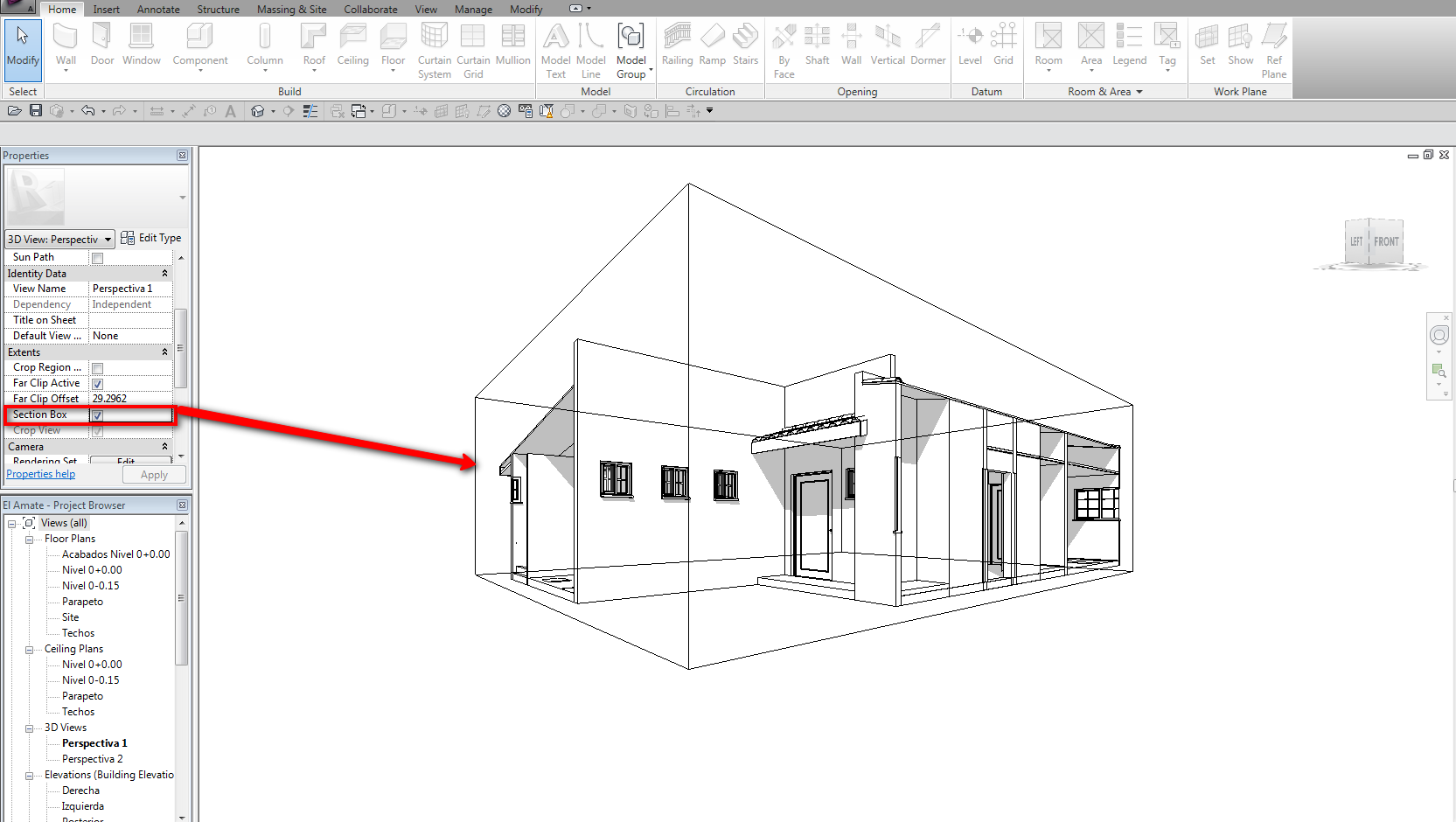

First time poster so hello y'all. This will likely be the first of many stupid questions but not before I've been through this and other forums to find an answer. So here goes: How do I isolate part of the building model in 3D? I would like to draw a bounding box in plan and just have that isolated area show in 3D.

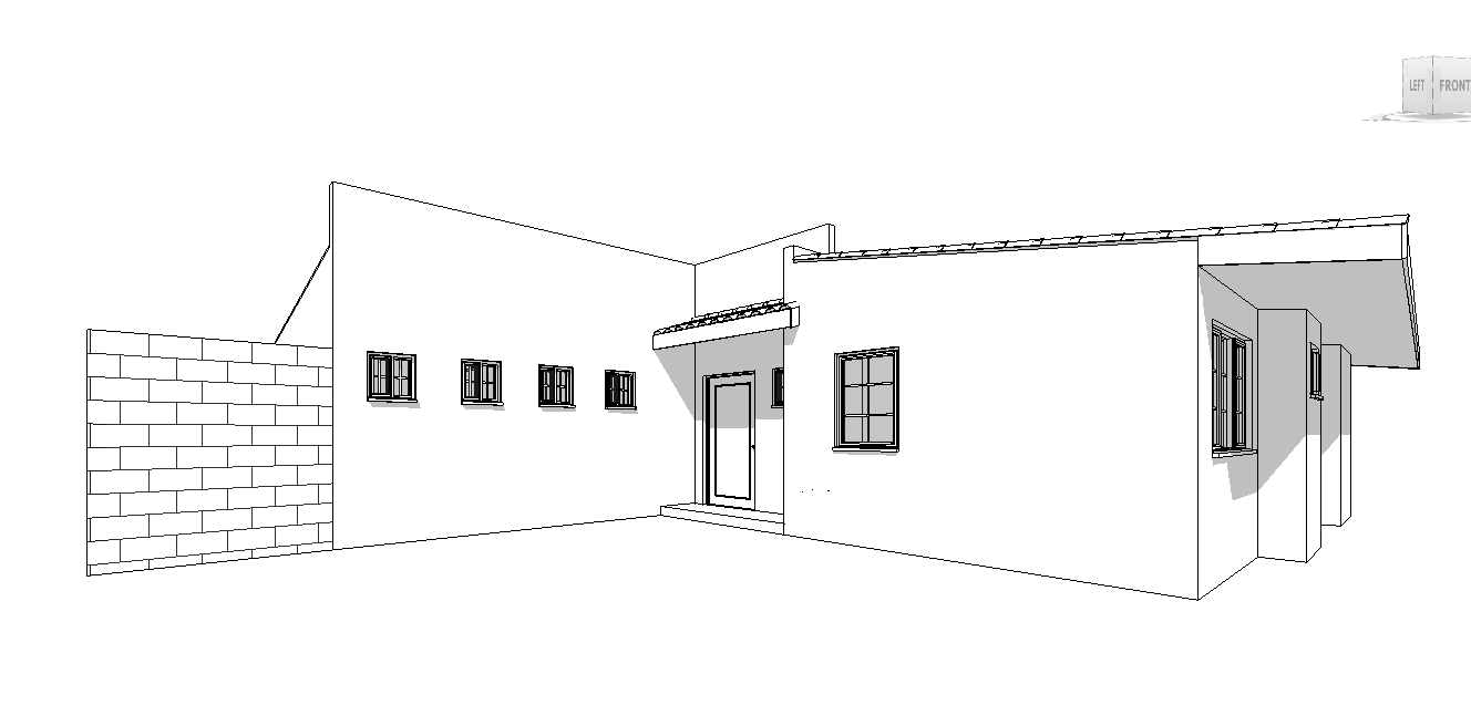

Welcome to Revit's world...
Maybe this is what are you looking for?

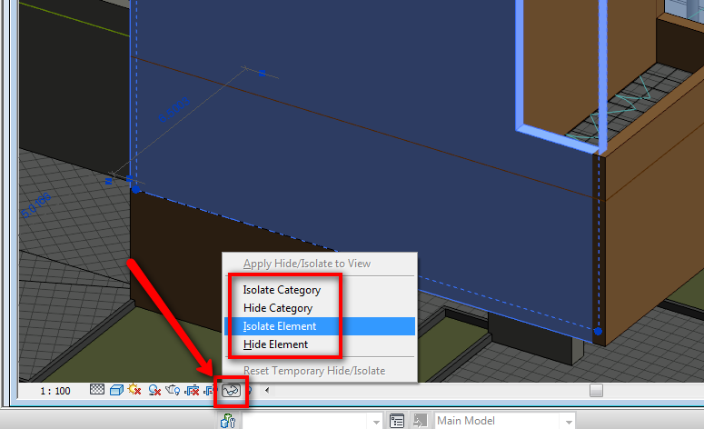

Sun, Aug 8, 2010 at 10:34:37 AM | Isolate Partial Model in 3D?
erland73
erland73 Avatar
Joined: Fri, Sep 7, 2007
738 Posts
4.5 Stars: 85 Votes
Welcome here....or maybe, this?.......
Permanently isolate object in Revit?
