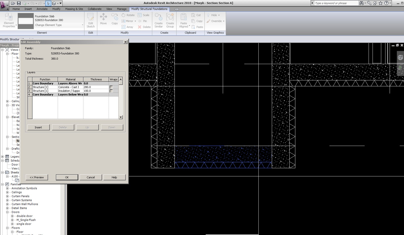

Hi,

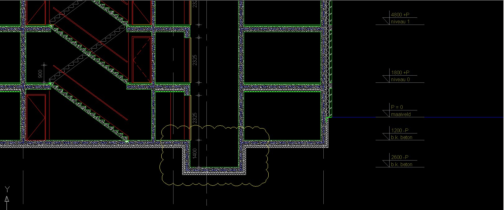

I am trying to create a  foundtion slab type, but somehow the material can not wrap with the wall.The wrap box can not tickable.
Attached pls find my problems in revit and the effect I would like to achieve.
Is ther anyone can help?
Thank a lot!

Those layers have the same priority in Slab and Walls? That material "Insulation" is the same material and the same NAME in walls? Did you try to use the "Join Geometry" tool between that slab and walls?

Join Geometry works perfectly! Thanks a lot!
