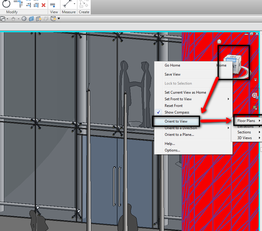

What you can do in that 3d view is go to view cube then right button and select "orient by plane" select the level you want, then you can control the visibility of elements in VG (visual graphics) or you can select the walls (elements) you don't want to see and with the right button (again) select "Override graphics by element" now you can turn them Visible/Invisible, halftone or transparent....

"go to view cube" - Where is it? Are You thinking about Section box? - there is no option "orient by plane" Sad
" select the walls (elements) you don't want to see and with the right button (again) select "Override graphics by element" now you can turn them Visible/Invisible, halftone or transparent" - This works fine ! thanks Winking

Sorry, "Orient to View", see the image.
