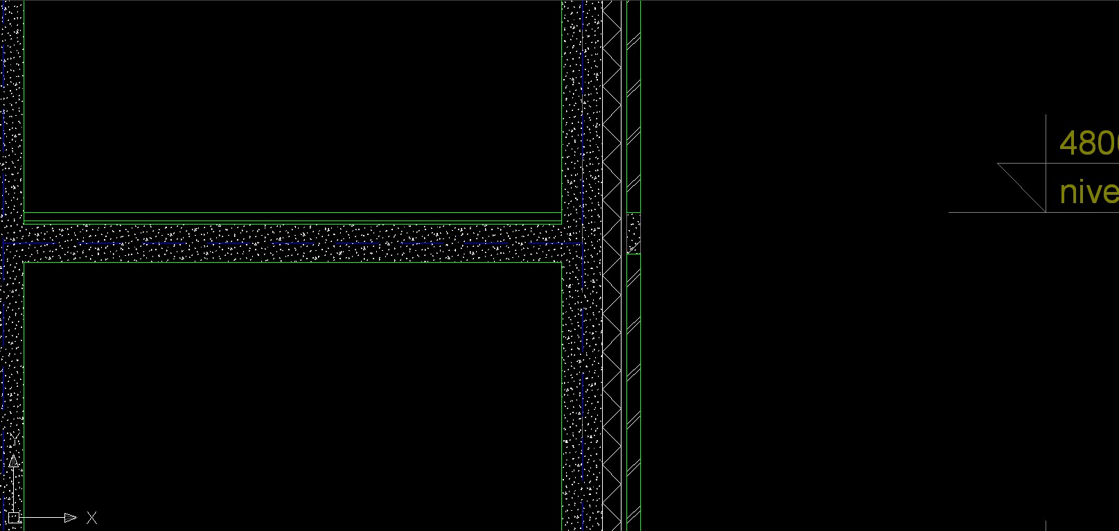

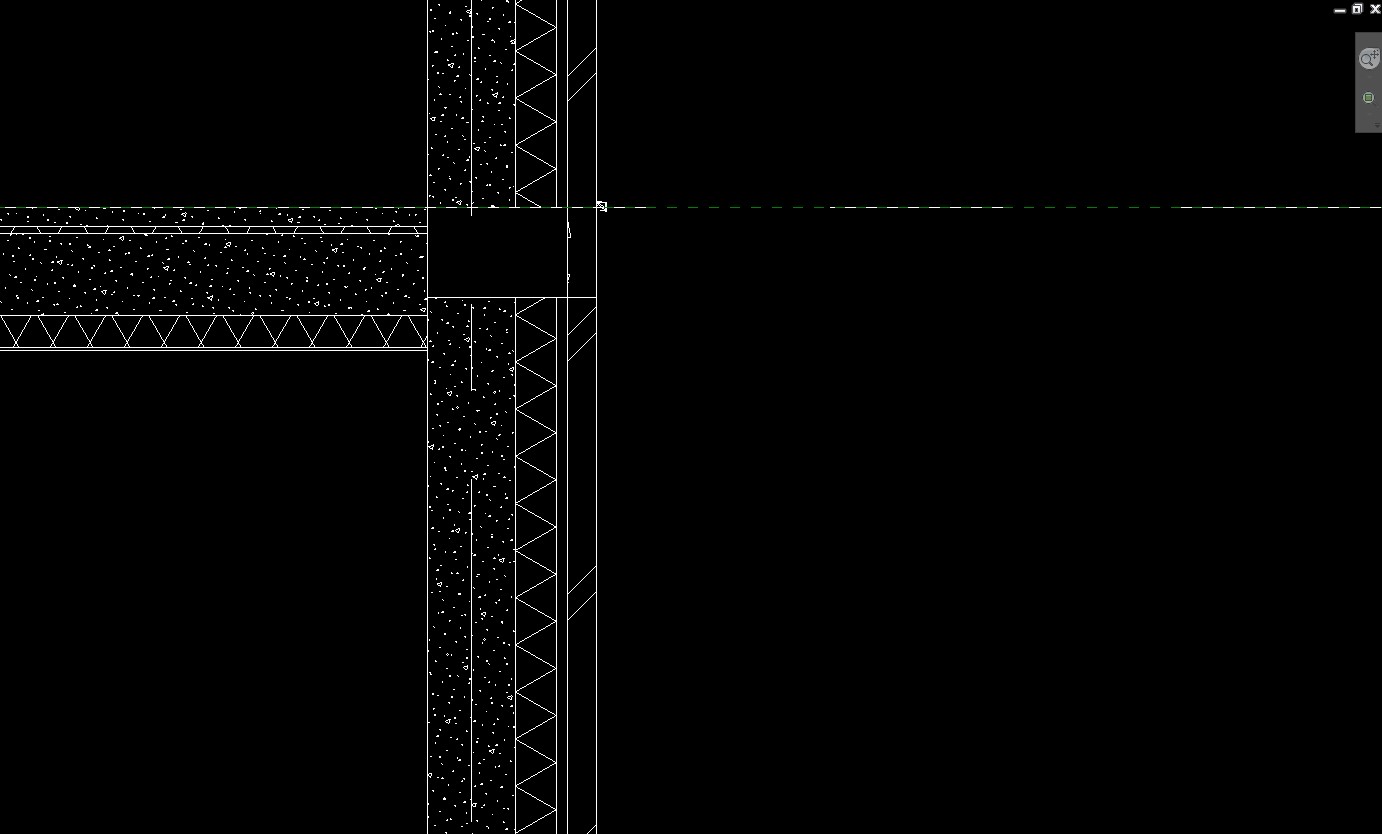

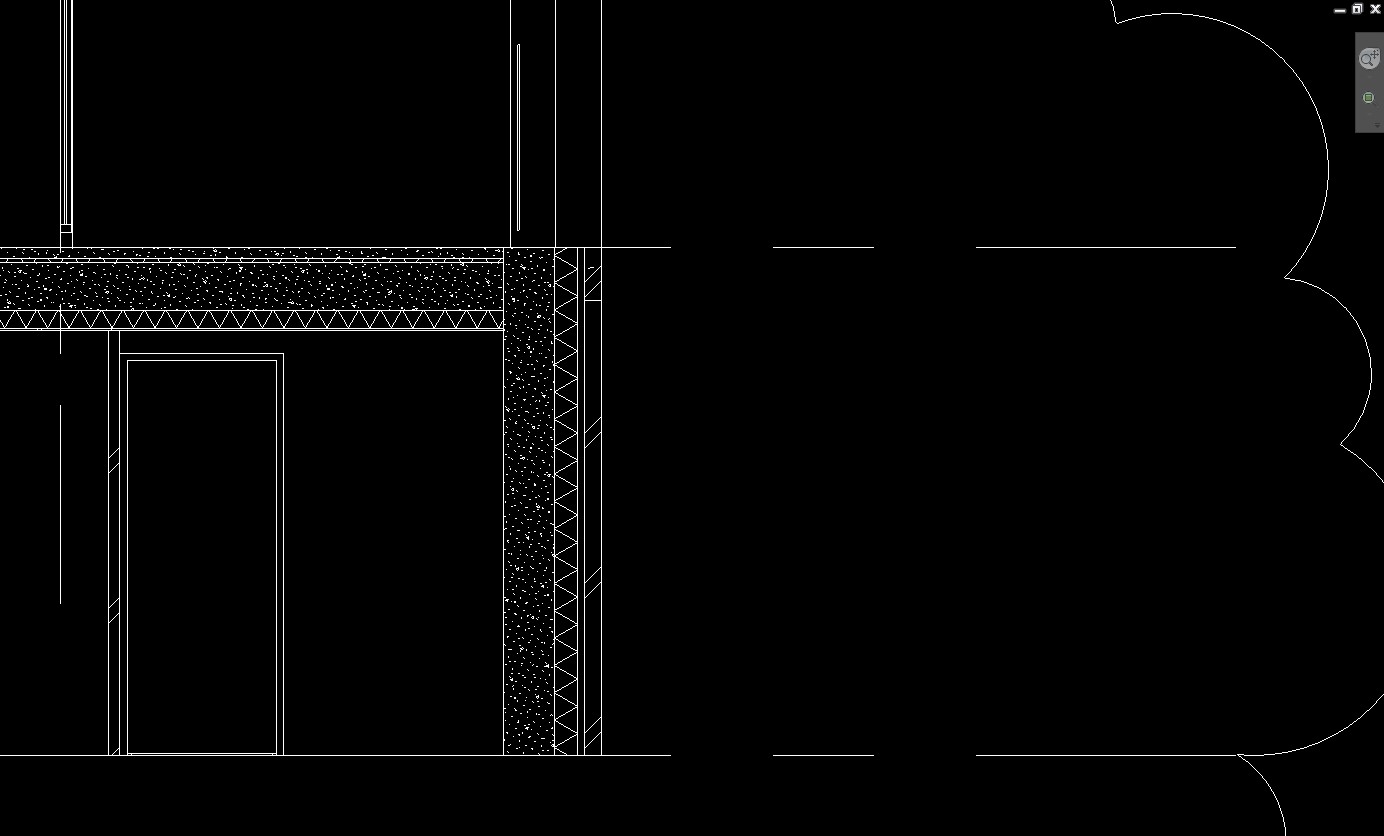

Hi,
I have some problems about facade wall connection. Basically they are two elements, one is basica brick wall with insulation, another one is just 100 concrete strip, but I don't know how to trim a small part from a wall (BTW, I have tried cut geometry, but it doesn't work)。Attached is the effect I would like to achieve.
Thanks

Why don't you use a simple Sweep or a Wall Sweep to create that concrete strip in that wall?

You are totally right, thanks Typhoon!

Just for the sake of resolution, the way to make cut geometry work is to create an in-place family, then a void extrusion.  Cut geometry with the wall now, before closing the family editor.
