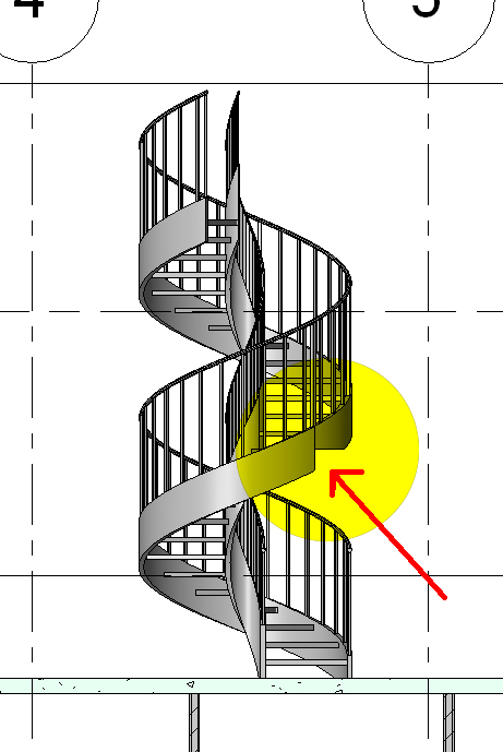

I'm trying to create a spiral stair that needs to rotate more than 360 degrees in order to reach the next level (the levels are 24' apart). It appears that you cannot sketch the run more than 360 degrees. Does anyone know how to do this or a way around it?

Unfortunately you need to split into separate stairs...

Hi, the solution to split the stairs creates an incorrect plan like double symbol for up and down arrow. Also, the stringer and balusters are not in the correct position. What is the remedy for this?

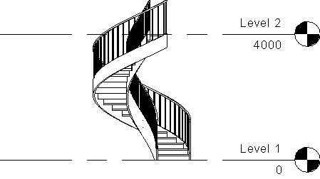

spiral stairs can be achieved by manual modelling, now regarding the stair tool in revit, you are limited to only a curved stair becuase conflicts with the number of risers, baluster placement and annotation symbol is at hand.. now usualy siral stair types have central post in it,
