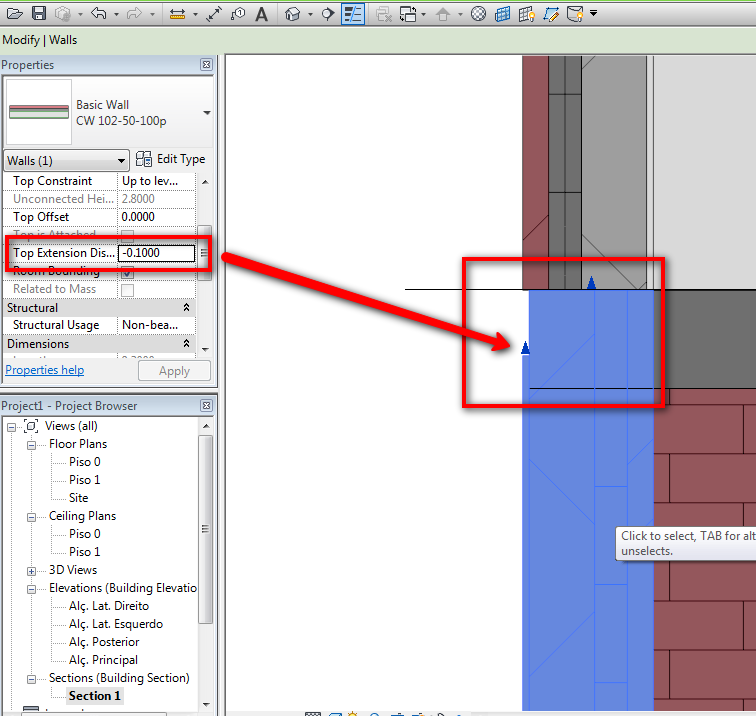

Is there a way to model platform framing without getting lines at the floor in the exterior elevations?  In other words, just a clean stucco wall...as it would appear in real life.

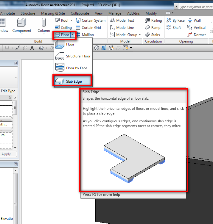

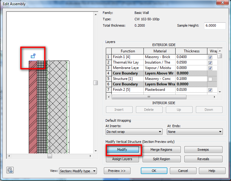

"Ah, the rub.  There is no way of placing a "Sweep" on the edge of the floor slab so the exterior material matches the walls...or is there? " - Yes there is, you have the "Slab edge" to the floors but in this case what WWhub told you is absolutely correct, there are several ways to correct this, if you create the slab like WW told you and you not "Attach" your wall to the floor the wall will cover the slab then in section view you can use the "Join" tool between your walls and slab to "Clean" them, BUT if you decide to attach your walls to the floor you have that issue but if you edit your wall (like you can see in the second image) and if you "Unlock" that stucco layer you can change the "Top Extension Distance" like you can see in third image....

INCREDIBLE!!!  Works perfectly!
Typhoon, you just got upgraded to a Class 6 Typhoon.  I totally missed the point Hub was making.  Thank you for clarifying Hib's recommendaiton.  The more I learn about Revit, the more it is like actually building the actual building.  One literally has to think in terms of: "How would I build this?"
