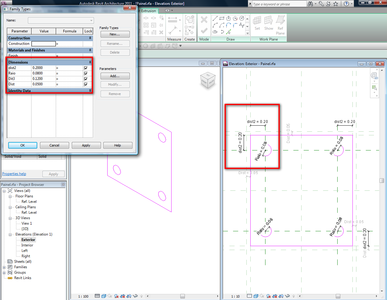

Currently working on a new library of structural base plates.  The challenge is that I need to make the holes in the baseplate move vertically.  I was able to achieve success on the detail components, but when I apply the same principals to a Model component it fails me.  I have been trying to set a label up from the bottom edge of the base plate to the center of the hole, but I am unable to set the dimension to the center of the hole.  Infact the void extrusion has become two half circles instead of centreline reference.  Attached is the file.  Can anyone help explain this?

" It would be nice to see a fully parametric baseplate on here or even some sort of editor in revit for them.  The challenge of trying place custom hole spacing is absolutely ridiculous.  Especially when you have 20 holes on a plate!"  - I don't know if this is what you really need but i don't use the VOIDS to create those holes parametric, just in the main extrusion create the ref. planes and the circles like you need, then create parameters to control that...

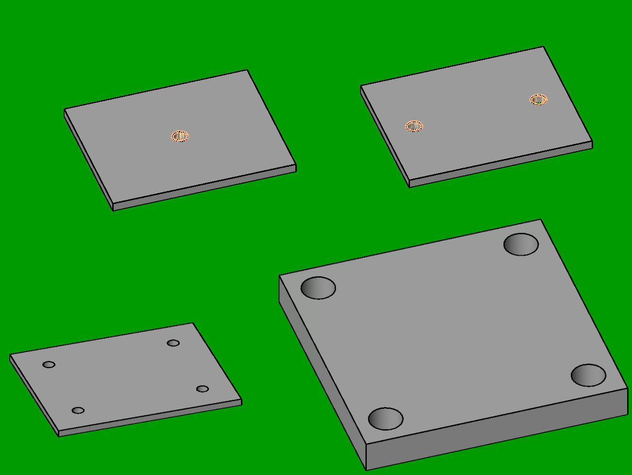

1 hole, 2 hole, 4 hole parametric
but not straightforward

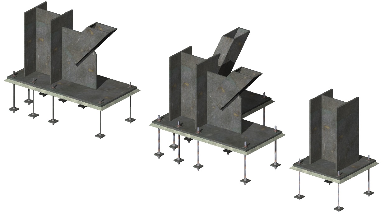

I agree with most the comments. Connections in general is an area where Revit requires much improvement. Even simple baseplates bring out a variety of limitations. A connection family should have the ability to maintain a relationship between ALL elements that it is interacting with. At the very least we should have some sort of dialog to place these elements efficiently and modify/update them when their hosting members are refined.
With that being said we don't have the above so the best we can do is to parameterize non-host based components. This still does work very well and is a huge step above AutoCad once you get comfortable with the family editor. Large quantities of holes/fasteners should not be any more difficult than a small quantity provided they are equally spaced. When they are independant (this may have been referred to as custom previously) it exposes limitations with constraints. Sure you could nest all kinds of holes/fasteners within the family to attempt to cover every possible configuration but the resulting family will perform poorly and likely confuse everyone except the creators.
Personally the best approach I have found is to create the basic baseplate conditions constrained properly allowing multiple equally spaced array parameters where applicable. Then also create a second set of "dumb" families in the same configurations but without the parameters. The second set can be manually editted (via the family editor) to create the not-so typical types. The end user can simply use the "save as" option, open the family edittor and move stuff around as needed without worrying about constraints.
