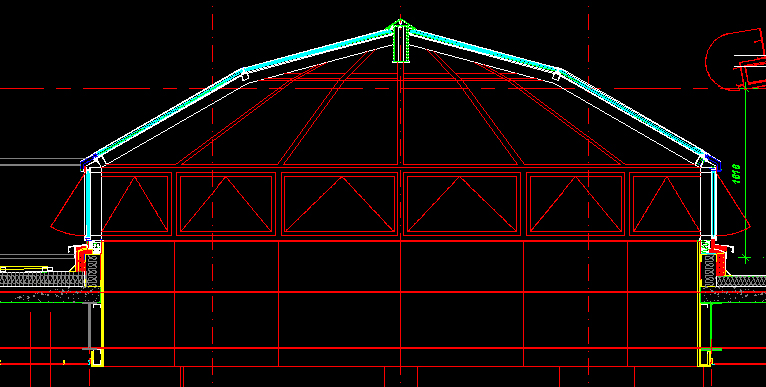

I'm trying to create a domed roofline similar to that shown in the first image below from AutoCAD.

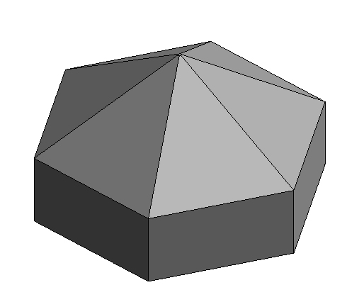

I thought the best way to create this would be to model it as an In Place component: Generic Model (see image 2) - I created two extrusions the top one tapers (couldn't get it to taper to a point though...).

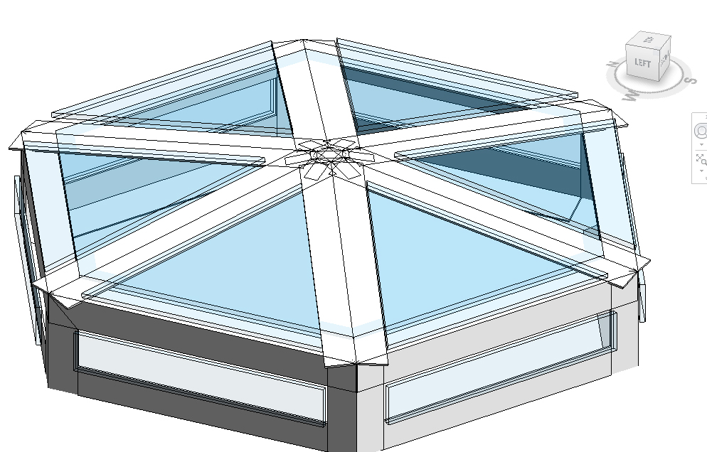

From this I selected the model and clicked Curtain System on the ribbon, with only boarder mullions - I used Rectangular 50x150. (see image 3)
This generally seems to work ok - My first question - is this the best way of creating this??
My second question is that the mullions don't join at the edges, each panel has its own mullion - which looks odd (see image 4) - can you give me any pointers to resolve this.

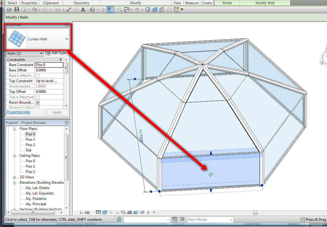

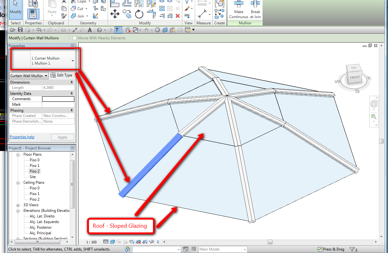

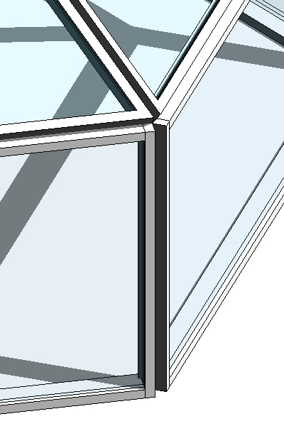

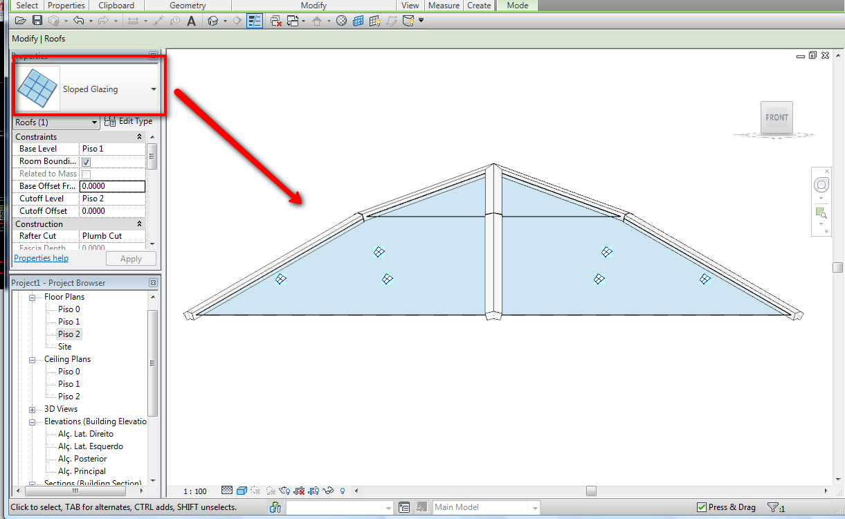

I think i created that with "ROOF - Sloped Glazing system" and use "L Corner Mullion" like you can see in my images...
Wed, Jul 14, 2010 at 5:17:19 AM | Creating domed roof light - mullion problem
Joined: Tue, May 22, 2007
5921 Posts
4 Stars: 205 Votes
The rest with curtain walls....

Perfect! Thanks for that.

In the real world that is how it would be made. They would fill in the gaps with either V angles or flattened V caps.

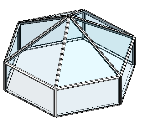

In the end I modelled the roof light entirly.
As it is made up from a haxagon, I model a 'slice' then copy rotated it.
The L shape mulltions work will, but it all goes a bit wrong, especially if want to put an L shaped mulltion at the junction between the two roof sloped - see the test I created (screen print attached)

Looks like you have it. You might want to look at what some of the manufacturer's have to offer for sloped glazing. Kawneer is a system that I have used before, but may not be available in the UK. http://www.kawneer.com/kawneer/north_america/en/bim.asp
