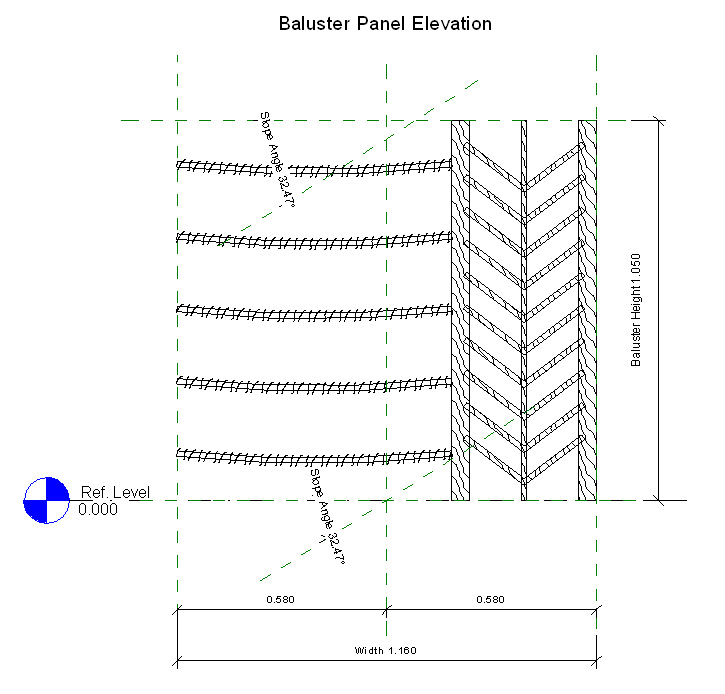

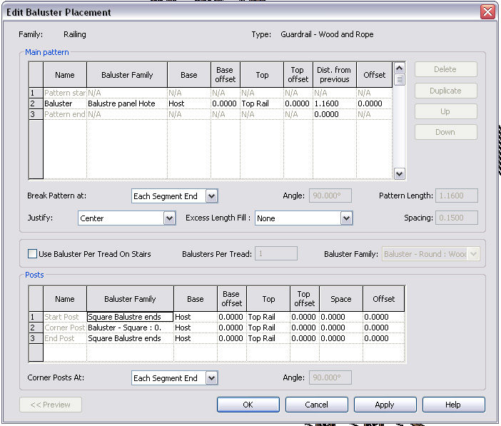

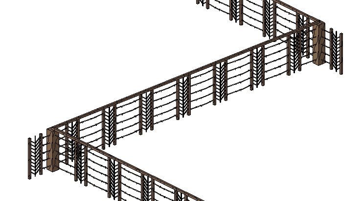

Perhaps this is not the best solution to such a custom pattern but this is how I did it. My problem is that the panels I created with the Railing Panel template do not justify correctly despite all my efforts. They always extend past the corners as you can see in the image I have attached. My fingers hurt from googling this problem and there are no specifics as to solutions. Any ideas?

You have a fixed width panel you are placing in a railing that is not a whole multiple of your panels.  Something has to give!  Possible solutions:
  1. Corner posts that include a partial panel and the railing is short
  2. Multiple railings in one location.  One railing is whole panel dimensions in length and another railing infills with a different panel for the end(s).
