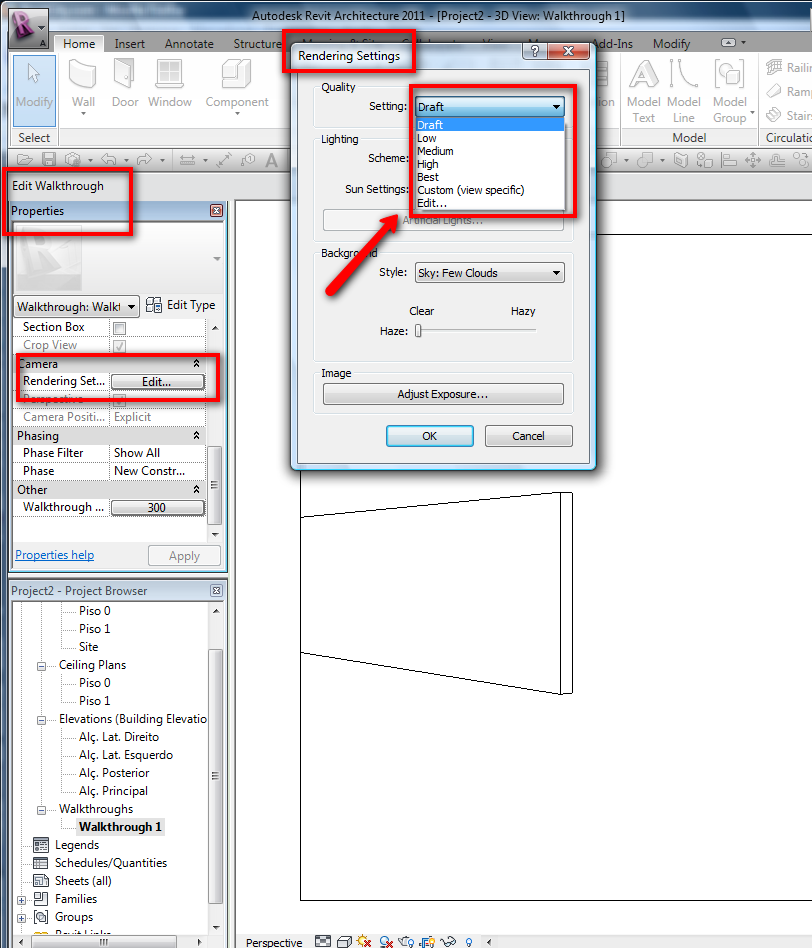

Hello everyone. I need to make movie file in revit and it's take  a very bad quality. When I maked rendering, Revit dosent ask me about the quality. In the end the movie is in bad quality. How can I make the diffrent? Thank you!!!

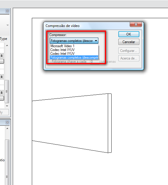

You can choose the quality in Rendering settings to your walkthrough and try to choose the best Codec

Hi, I found the option in Element properties - Rendering setting. Thank you for your help
