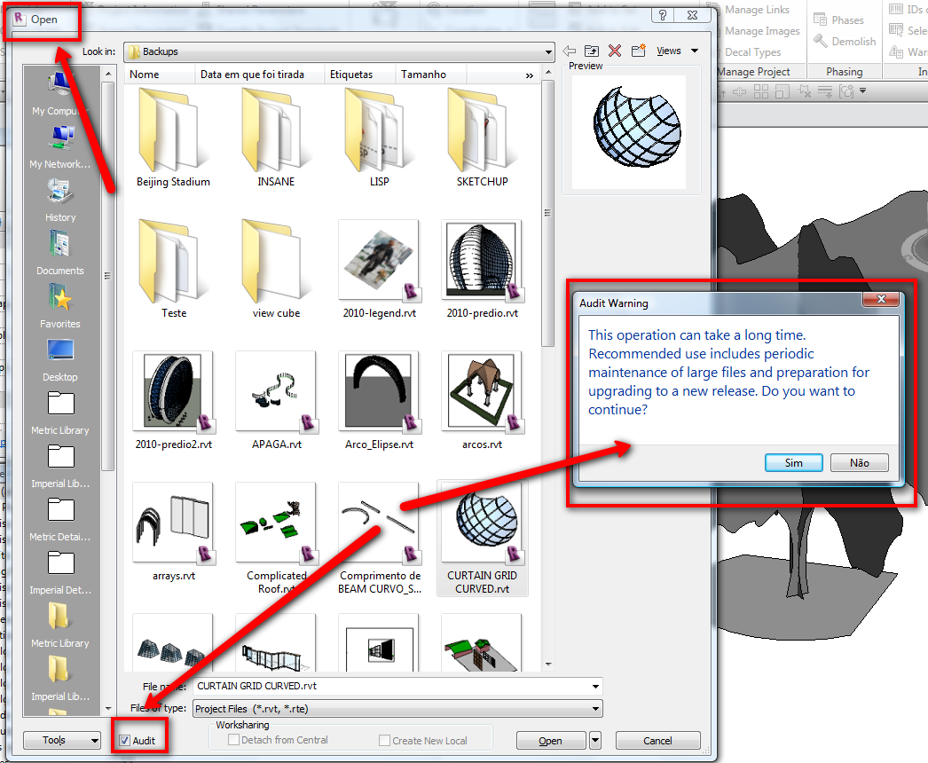

Just download and run CCleaner, maybe this help, also, try to open that file with "AUDIT" too.
