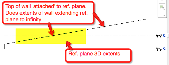

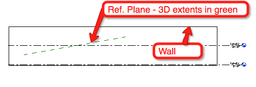

I still stand by my assertion.  Maybe I didn't explain it enough, but while reference planes have a 3D extents, logically they really do go to infinity.  The green dashed line that represents a reference plane can have a 3D or 2D extents like a grid element, but that really only adjusts the display or physical manifistation of the reference plane in the view.  If you base a workplane on a named reference plane your workplane will not be restricted to the 3D extents of the reference plane.  If you attach the top of a wall for example that is longer than the 3d extents of a reference plane, Revit will attach the wall top extending the reference plane to infinity logically for the attachment.
Granted this is a fine fine distinction of reference planes by advanced users, but the newbies might benefit by knowing the distinction of logical vs. physical display of reference planes in a project.
