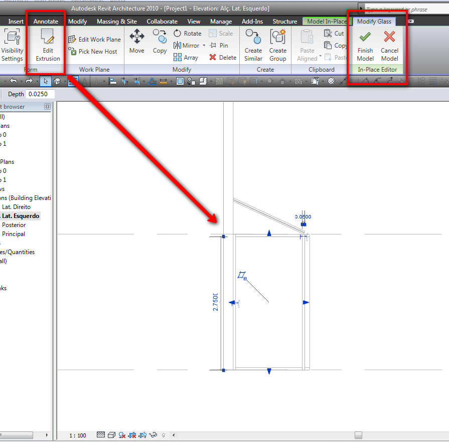

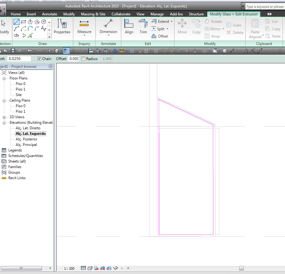

Select the curtain wall and in the options bar you have a button "Attach" then pick on that sloped glazing OR if that don't work edit the curtain wall panel and change the shape like you want.
