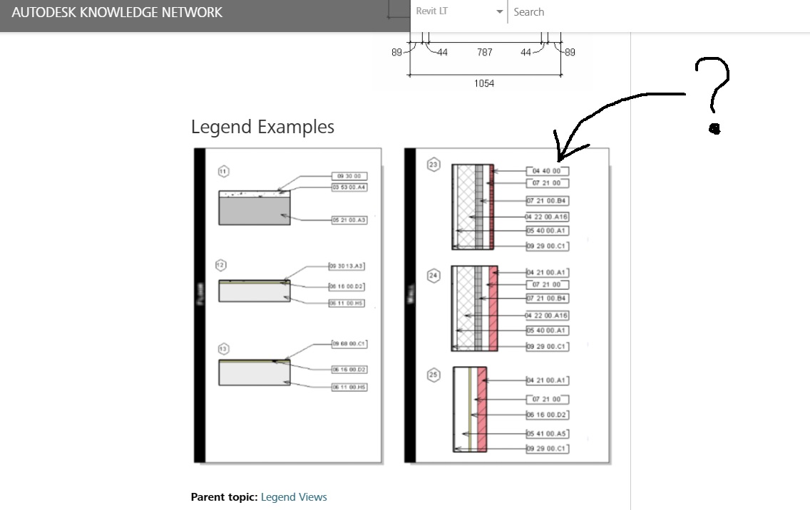

Wed, Aug 9, 2017 at 4:15:22 PM | Tags in a Legend?
sllana
Joined: Wed, Mar 2, 2011
106 Posts
5 Stars: 2 Votes
EXACTLY, totally worthless. Or how did they do this?
Edited on: Wed, Aug 9, 2017 at 4:15:59 PM
Wed, Aug 9, 2017 at 4:25:11 PM | Tags in a Legend?
I know I said in 2010 that you can't use tags in a legend but you can use material notes (tags).
Wed, Aug 9, 2017 at 4:39:18 PM | Tags in a Legend?
sllana
106 Posts
5 Stars: 2 Votes
Yay! Material tags work. They show the "description" field in the material.
