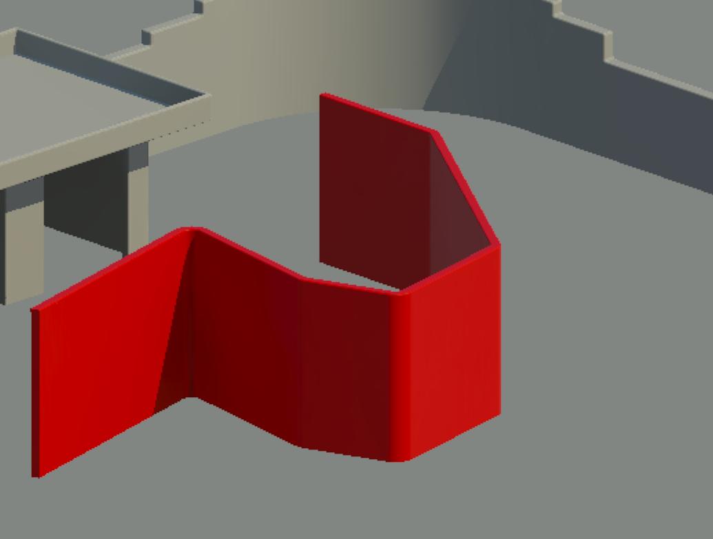

hi ............ im just trying to make walls with round edge the sides and even the top edge of the walls........... like in 3dsmax we have round corner edge material.... which make the model appear with round edges.... but in revit there is no as such material.... so if anyone could help how can i make the wall edges round of appeared to be round ...........\

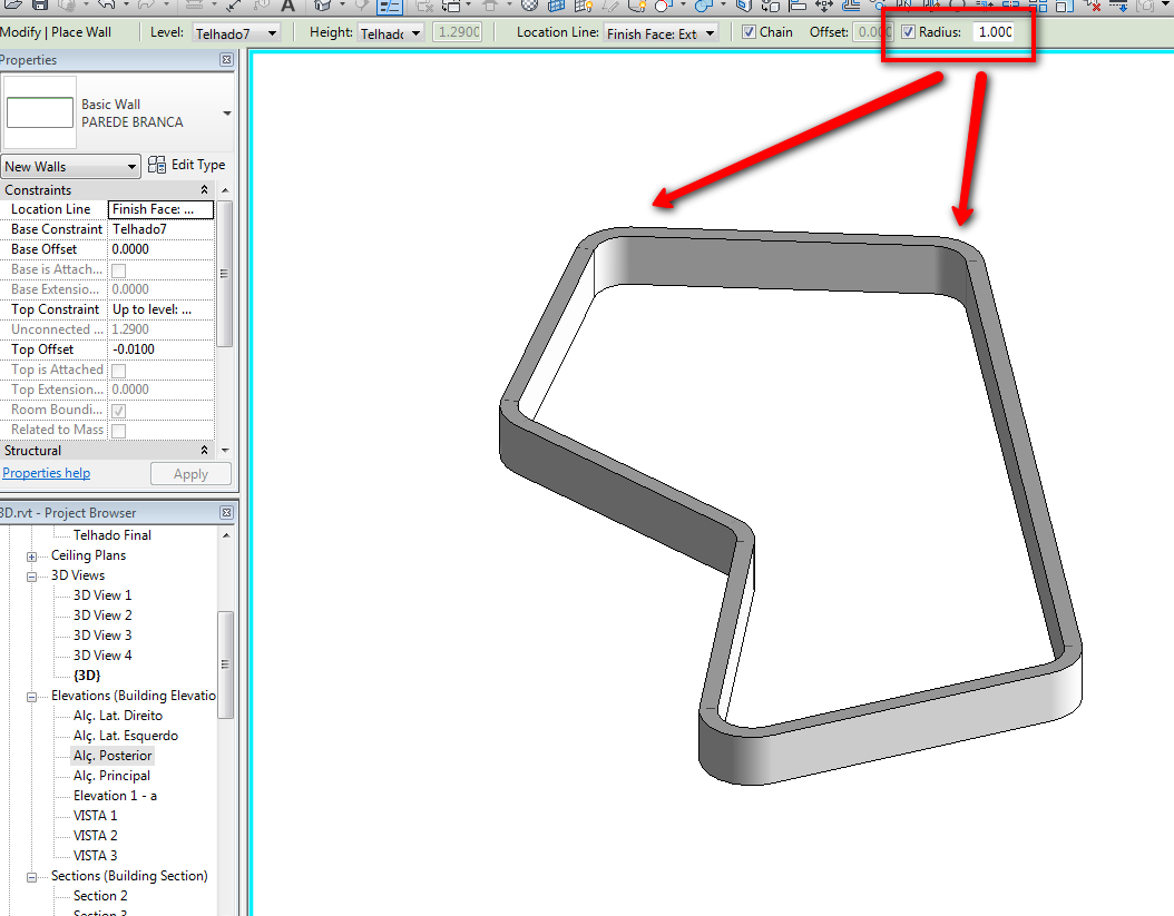

When you create the wall you must look at the "Options Bar", like you can see you can create "Radius" in your walls, BUT at the TOP you must use "VOIDS"

thnx for a quick reply .. @wwhub can u pls explain a little more about it.... ive tried added sweep at top of the wall ... it works but the issue is my walls are at different height so ... if it cuts when the wall height varies.....
attached an image.....

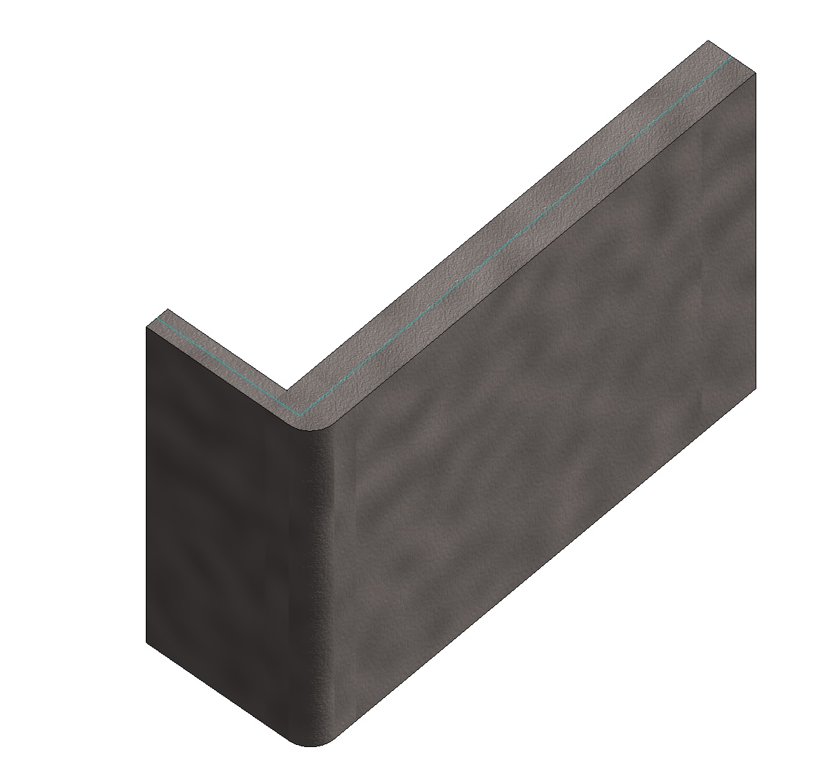

2010 - Here is a simple family - face based that will round a corner.  It is placed from an elevation view on the wall.  The insertion point is 1' - 4" from the corner and it is a 4" radius.  The top is parametric so you can adjust the height.
Take this and look at how it is made - adjust it as you need or make a new one.  LEARN & have fun!

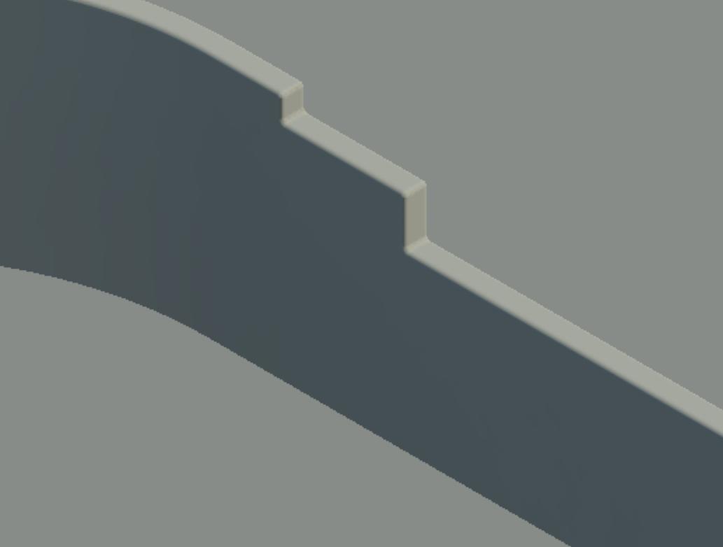

still confused ... guess im a beginner thats why ..... and what im looking for is the top edge of the walls to be smooth... and when the there is variation in height then the vertical side edges to be smooth too.....like ive attached the image for better explaination...........

Sorry but there aren't a easy way to do that in "Top edge", like WWhub said, or you create an "In-place" VOID like you want in each part of the wall or you can create a family.
Wed, Jun 30, 2010 at 6:57:14 AM | Hi ........ Round corners of walls..........
Your best option for what you show now is an in place void sweep that runs along the edges of the wall.  You would have to have several of these to do what you want.

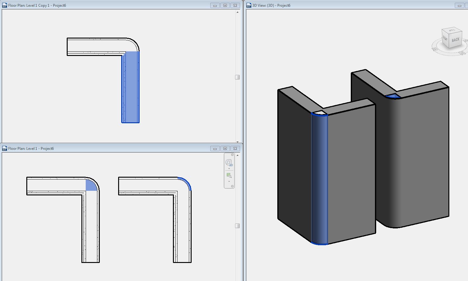

I'm trying to do something like in the pick attached. i'm not being able to do it without "cheating". What i did was joining 2 walls with a collumn with one round corner. but i know it's not the right way to do it. i'm not being able to do it with mass and then assign a wall because the radius os curve is 200mm and the walls are 400mm and 200mm and it's revit says can't make that wall curved.
any suggestion?

Don't use mass faced walls - you will regret that because of the limitations and modification problems.
A simple in-place or face based void family will do this.  Then just paint the face.  I suggest the face based void because you can use it in multiple places and projects.
Will your layers in plan wrap the corner correctly?   No.   This is when you use the edit cut profile in each affected view.

…or create an extrusion (in-place or family) for every layer at the corner, if you want to show them in plan.
The void, as per WW, is the quickest way though.
