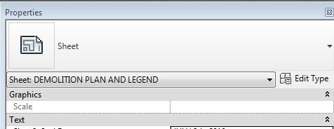

Hello,
I just tried to change a property of multiple sheets at once (select sheets > properties), yet this doesn't seem to work anymore.
For clarification, I have a sheet index with all properties listed in it, rather than changing them one by one, I want to change a property like 'drawn by' and be done with it. I used to change properties for all my sheets all the time in 2010, yet now, I just can't seem to get it done.
Can somebody explain why this happens, and how I can get this to work again?

Thanks for your response, but unfortunately that's exactly what I'm doing (same as I did in 2010), yet the properties dialog changes from my selected sheets to the view I'm in once I've tried to change a property (and of course, nothing changed).
I can change the properties for a single sheet just fine, but as soon as I select more then one I'm getting this issue.

I was frustrated by this behaviour as well, but then lost interest and just dealt with it for a while. Earlier this week I was trying to squeeze some added performance from my aging workstation and decided to set the Windows 7 Performance Options to best performance (Start, right-click on My Computer and Properties, Advanced System setting, Performance, Settings, Visual Effects Tab... <really Microsoft?>Winking. I set the bottun to "Adjust for best performance" which unchecks all the bells and whistles in the chart below. To my surprise, back in Revit I got back my ability to select and apply properties to multiple items in the Project Browser at once. I don't know which Performance adjustment/ checkmark in particular caused me to get  back this behavior, but I bet the Aero interface on Windows 7 is the culprit for this bug. So now I live (happily) with old school Windows decorations (reminds me of Windows NT)... YMMV but I hope that helps and that Autodesk and MS fix this on the next go around.

I was having this problem in 2012 also, but I finally realized that I had to have the current view open to a sheet that I
wanted to change and then when I selected the sheets in the Project browser and changed a property it worked.  You
might also have to select the current sheet first and then the rest of the sheets with shift-click.

It is indeed a Win 7 conflict problem with revit.
Untick this box - 'Enable desktop composition' in the performance options.
(Start, right-click on My Computer and Properties, Advanced System setting, Performance, Settings, Visual Effects Tab)

I've been seeing this problem as well, and though I haven't tried the Windows setting (headed there after I post this), I have been able to make it work. It seems that if you select your sheets and click in the properties window the properties change back to your current view. Click back into the project browser (I click on the title bar so I don't deselect any views), then back into the properties window. This time it shows the properties for everything.
