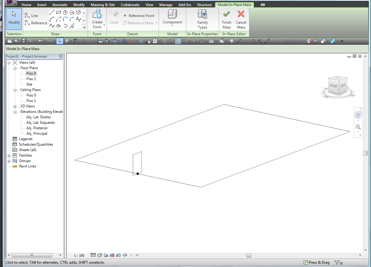

Hi,
I'm trying to add a vertical profile to a rectangular conceptual mass and it will only permit me to add a horizontal profile. How do I change this? I've searched through REvit tutorials, this site, and Design Reform and found nothing. I need to construct an undulating roof - been at this for weeks. ThanksSmile

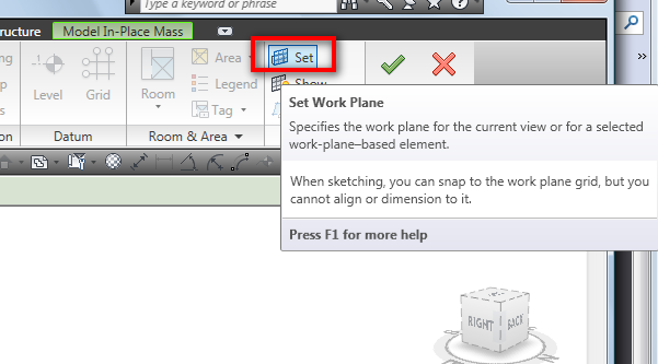

You must "Play" with the "Work planes"
