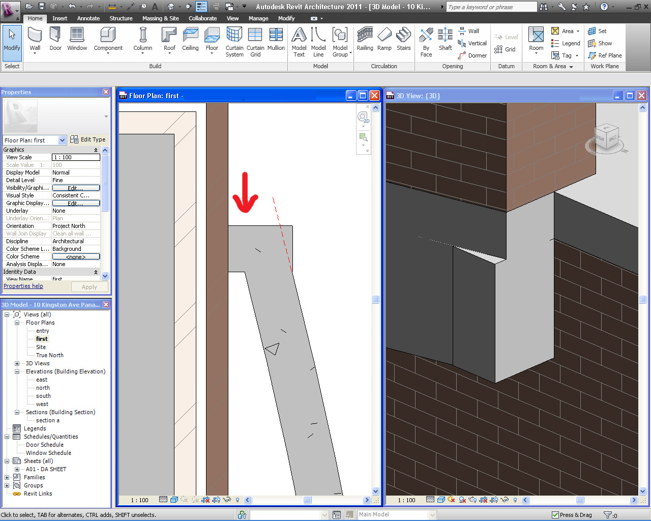

Guys, how do I make the beam with the arrow join with the arched beam without having to 'model in place' the whole thing?
I just want it to end where the reference plane is.
Any ideas?
Cheers.

draw another ref plan in plan and tell the beam to cut to the ref plane.
