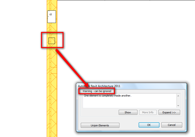

Having trouble understanding why I am getting an error message when I want to place a column (8" x 8"Winking in an 8" wall. It says "one element is completely inside another." I know this. I want the column to be in the wall.

Because you are using "Architectural Columns" and not "Structural Columns" and that is not an Error is a warning...
