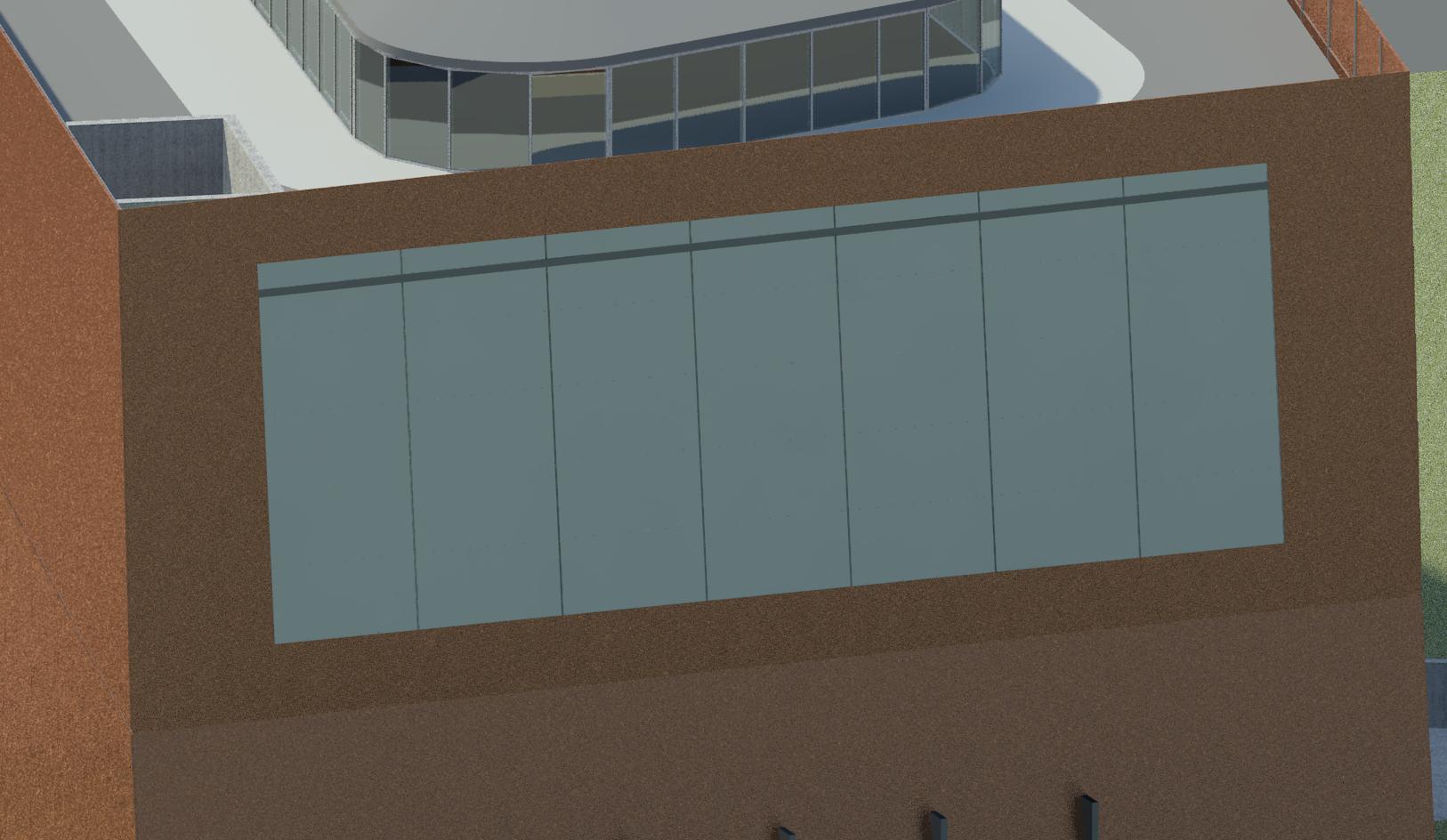

Like this? Curtain Walls....

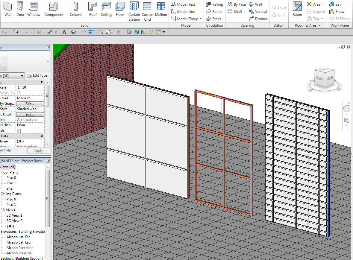

Like I said: "Curtain Walls", just create a "Curtain wall panel" family like you want, in project divide the curtain wall like you need and replace the panels by the NEW panel you created.
Something like this: http://www.revitcity.com/gallery.php?action=view&gallery_id=7803

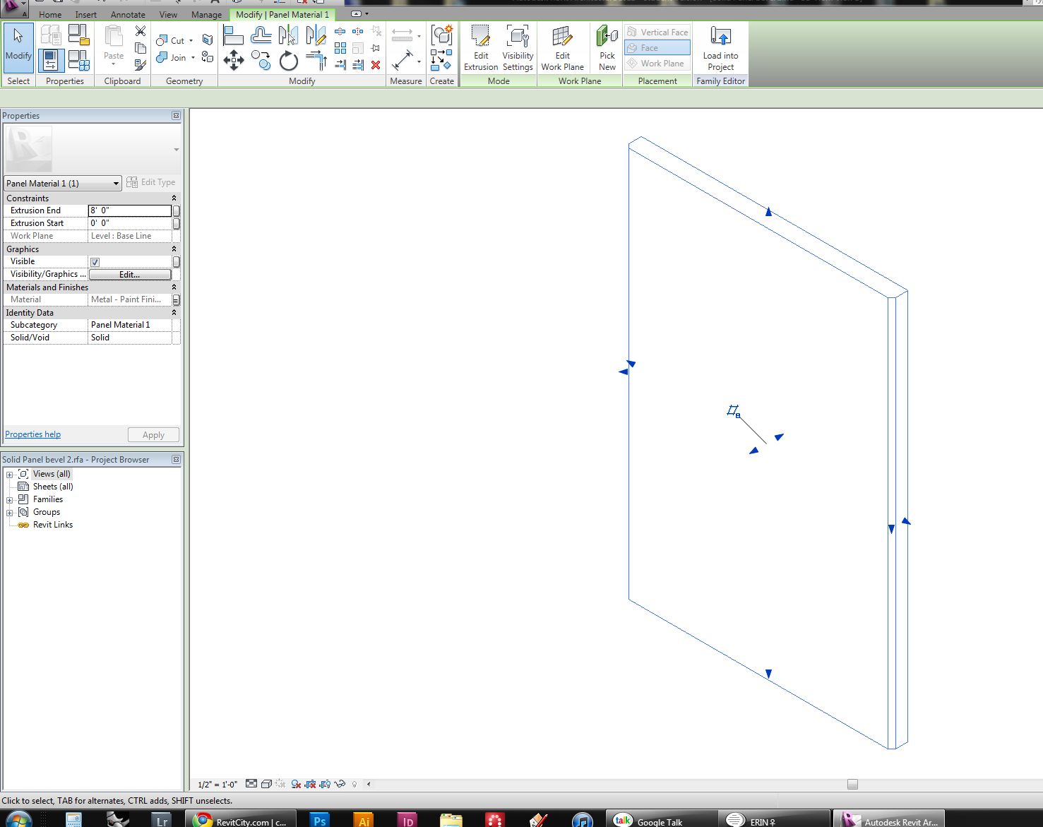

Ah, well I got as much as this.
It gives me an error because they aren't perfect rectangles or something...sigh.
I edited the original Solid Panel that comes with revit to have a slight bevel.  It only bevels two sides because it's an extrusion and then of course the error with using them in my project.
Would someone mind helping me create a more flexible beveled that can adapt to differing size panels?

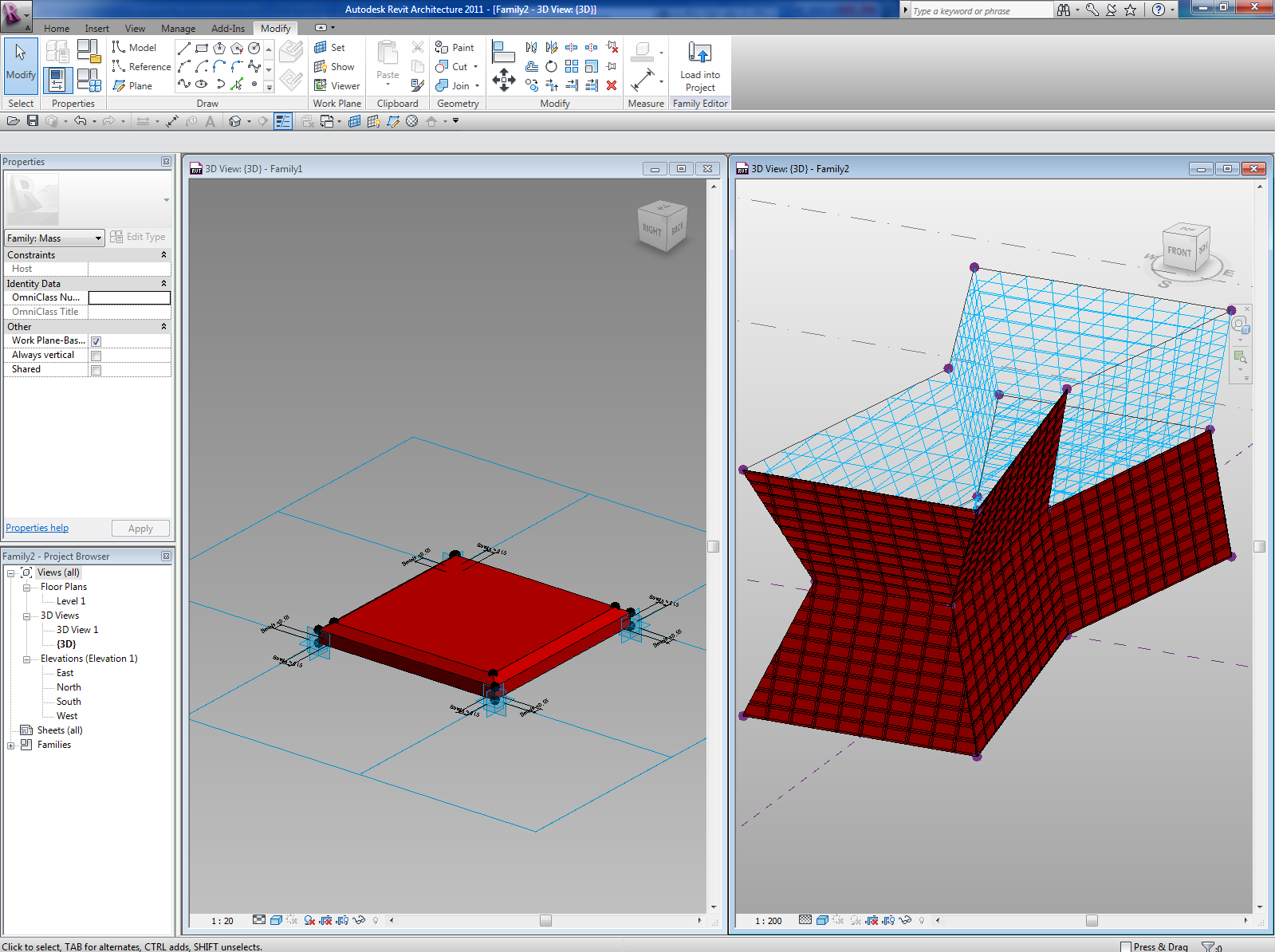

"It gives me an error because they aren't perfect rectangles or something...sigh." - That's correct, in this case you will to create a "Metric/Imperial Curtain Panel Pattern Based" and create that in a different way, check this blog from ZACH KRON:
http://buildz.blogspot.com/
http://www.youtube.com/user/zachkron#p/u

something like this:
