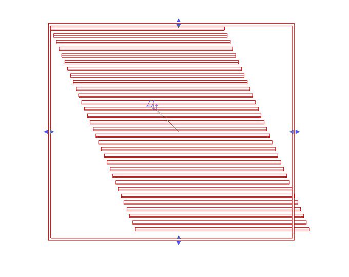

I seem to be having an issue with a version of this... I have a working formula for arraying timber beams in a brise soleil setup (Calculated Internal Width / Fin Spacing) which works fine front to back but when increasing the width the array slants from one (interpolates between its current location at one end and the new location at the other (pics attached)) Ive been trying to set it up with instance paramter dimensions to allow quick control on plan and with using both in plcae geometry and nested family geometry.. Revit 2009 SP3
Thu, Jun 24, 2010 at 10:09:49 AM | Array Formulas
#9
Dafpfy
Joined: Sat, Dec 29, 2007
286 Posts
3.5 Stars: 11 Votes
Align and lock the first and the last to a ref plane.

Fri, Jun 25, 2010 at 4:31:21 AM | Array Formulas
#11
mercat11
Joined: Wed, Aug 10, 2005
16 Posts
Thanks for reply - I had tried aligning and locking to both the frame and ref plane but it seems that if beam is group arrayed (for formula) then this overrides the align and lock. Having a new parameter to control the nested instance dimension parameter (for the nested beam family) means an align and lock isnt necessary. It seems to work and flex ok with this method.
