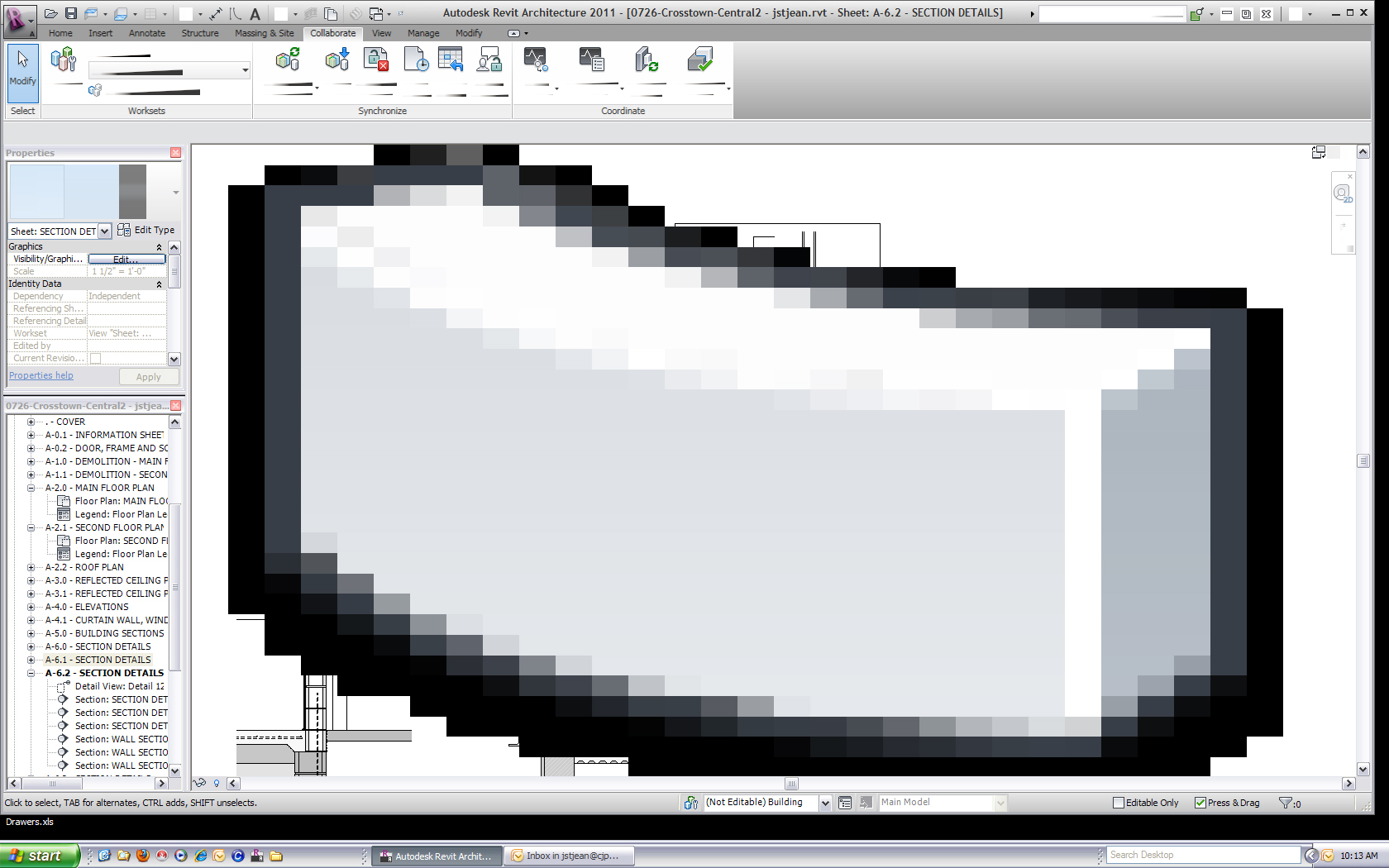

I've been having display problems with both revit 2010 and 2011. See attached image.This usually happen when i've been working in the program for over an hour or so.The display goes bonkers, and the toolbar icons change. sometimes the COPY icon is where the SAVE icon should be, and so on. The image attached shows a huge icon appearing in the drawing window, the only way to fix this is to restart revit.The file I'm working on, is slightly over 100mb, I'm thinking that might be the problem. I'm also running 64bit which may also be the problem. Any feedback would be appreciated. Does this happen to anybody else?

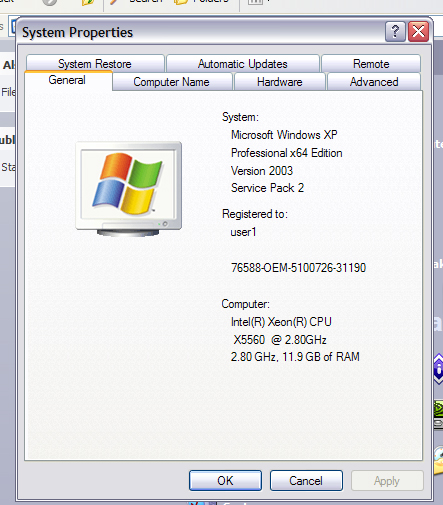

How much memory do you ahve on your machine?

I'm running 12GB of ram. But maybe i've got some faulty ram?Attached is system info.

in 2011 my toolbars tweaked out yesterday.  Several tabs and tools coalesced into one called "Sweep-->sketch-->sketch-->modify"  But I haven't had graphical issues.  (and I wasn't working in a sweep) It seemed to be a bug with the program, and restarting fixed it.    Strange that this would be a hardware issue.
