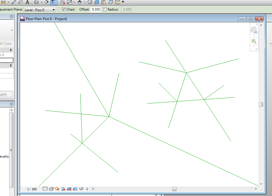

My problem is accurancy and work with snaps. I have 3 lines. All lines have to intersection in one point. I create them with snap. but  if I zoom in I see that lines have not intersection in one point. Why?

The problem is there is distance between crossing lines when they should have intersection in one point. (when I try intersection two lines in one point or I align one line to another one. if I zoom in I see distance between these lines and I can measure this distance.)
I attached file there are 3 lines and its should haveintersection in one point but I see distance and I can measure it.

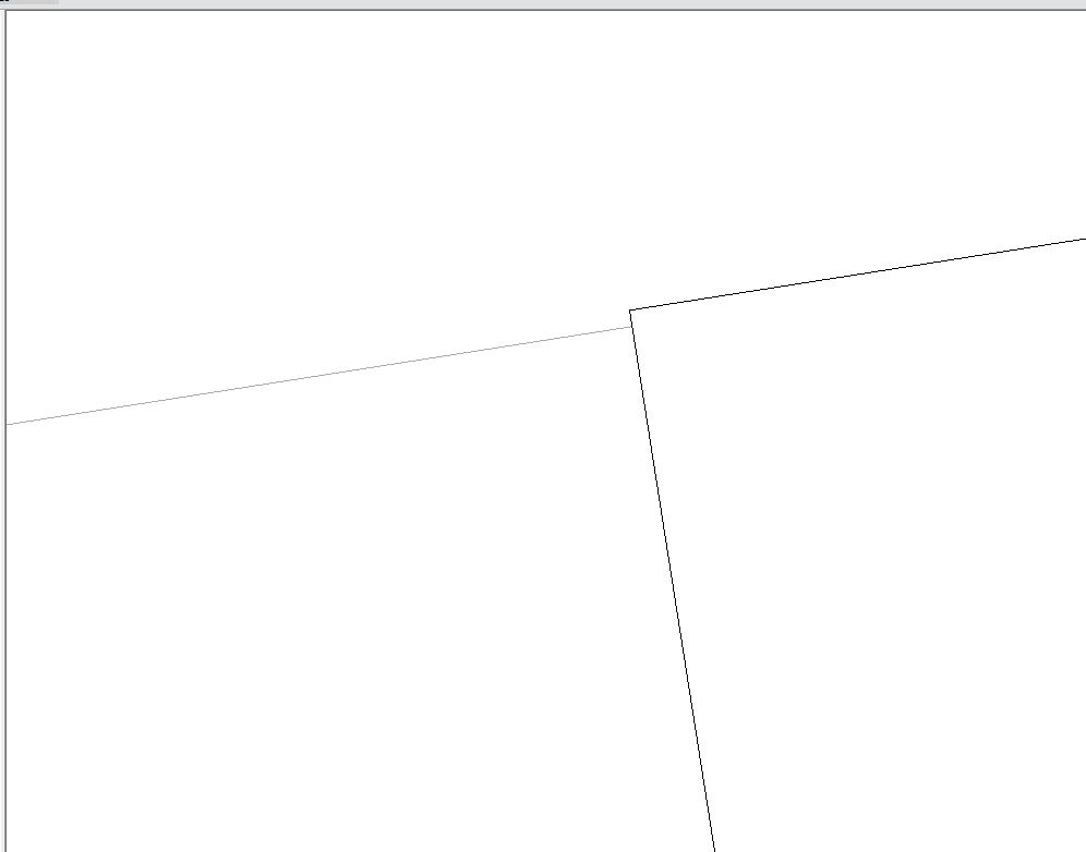

I attached 2 files.
In first file I should have intersection in one point 3 detail lines. But if I zoom in I see destance.
In second file I have to align wall and imported CAD geometry. (imported geometry in halftone).
I think the problem with intersection between angularly geometry.

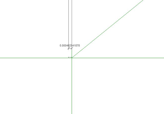

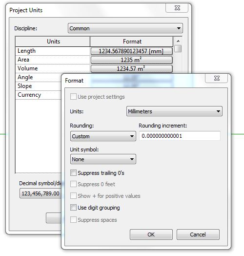

The accuracy in project is 0.0000000000001 mm (metric system)- the 1st attached file.When I zoom in intersection betweem 3 lines  I see that lines have nointersection in one point and I can measure this dimension.The dimension is 0.000456 mm. - 2nd attached file.

Those are really crazy units.  I don't see anyone applying that kind of standard to buildings - to sites, yes, to manufactured items for buildings, yes but not to building construction.
We model to an accuracy of 1/256" and we rarely dimension anything smaller that 1/16" and most times it is 1/8".

You are working in Milimeters with 13 DECIMAL PLACES????  Confused
That dimension 0.000456 mm = 4560 Angstrom or 456 nm.... Are you working on INTEL creating Microchips or something like that?
