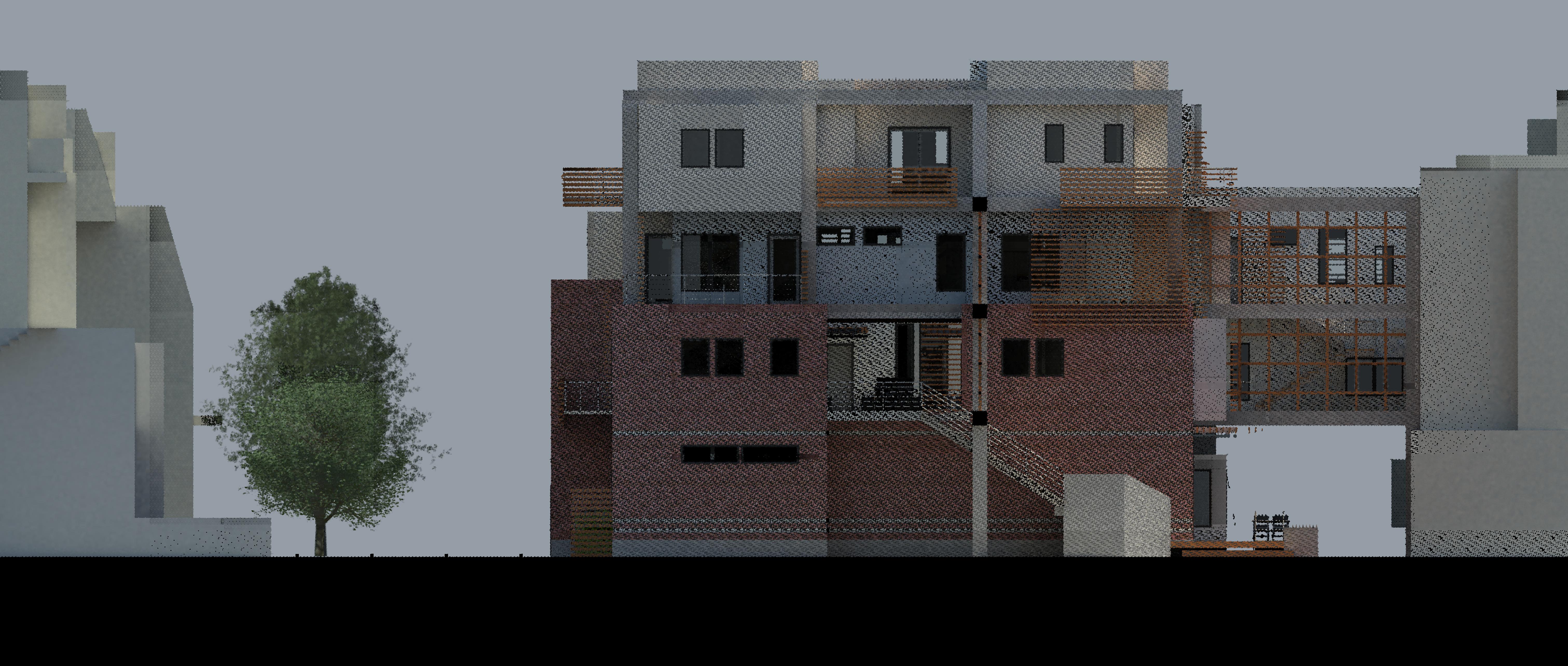

I believe I've come to a point that I've had to cut myself off and start getting the information out of revit and onto paper, so late last night I began setting up stuff to render. That's when I ran into problems, and I was wondering if you had any tips or experiences that could help me out.My file, including the families I've loaded into it, is about 36mb.  Since you can't render an elevation (there's no render button) I looked online, and created 3d cameras that have no perspective on them, and created "elevations."for each camera I set up the section box and the crop view so that it only would render what I needed it to.What ended up happening the first time was that on each computer, the program would run for about a half hour and then just stop rendering further.  What came out was a "finished" rendering, in that the dialogue said it had reached100%, yet I could clearly see about 60% of the image that was not rendered on the "second pass" higher quality render part.  CryingYou know how renders do an initial pass on stuff and then go back and clean it up, well it didn't go backa second time over a good portion of the image.Have you had this happen before?  The image is set with shadows etc., and is set at rendering at HIGH at 150DPI. The size of the uncompressed image on average was about 107mb  I think, and the crop box setting, since these are actually scaled, is  that it's a 1/4" rendering, so the render was either 30 or 60 inches long. (depending on the actual size of the model)What I hope to do is render this scaled elevation render and then export the line drawing with shadows of the exact same image, and then photoshop the two together... the render is just giving me this trouble....In your experience, how do you typically set up a rendering in terms of settings? HIGH, MED, etc and then what DPI?  I'm not sure why the renderings are doing this...Please let me know if you have any pointers or experiences similar to this. Hopefully I've explained enough about this for it to make sense.
*** END EXCERPT ***
 There are no custom materials, and the only families ive loaded of stuff are from the downloads here at revit city.  In each render I did turn off by category furniture and rcp trees....
 I think I've said enough hopefully.  I think I attached an image of the render, alas I was not quick enough to get a screen shot. Help if you can, comment on anything please!

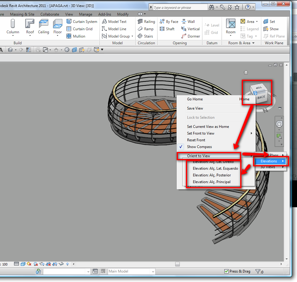

"Since you can't render an elevation (there's no render button) I looked online, and created 3d cameras that have no perspective on them, and created "elevations." -Well you can in 3D view orient the view to an Elevation View, you don't need to create a camera view to do that... But i never had that kind of problems and I work with 100mb files, well, i work with a Dual-core 2.4ghz and 8Gb of Ram, Windows Vita 64 bits and Ati graphic 1650 512Mb ... maybe a graphic issue, memory issue, try to "clean" the "Temp" files, use CCleaner...

So I tried the render regions of different drawings, it sped up and actually worked in little to no time (comparatively) so I am just going to have to stick to MED quality and 150 dpi settings.
The problem I am having now is that once it finishes rendering, and I click export, i go through the motions but nothing actually saves... anyone have this issue?

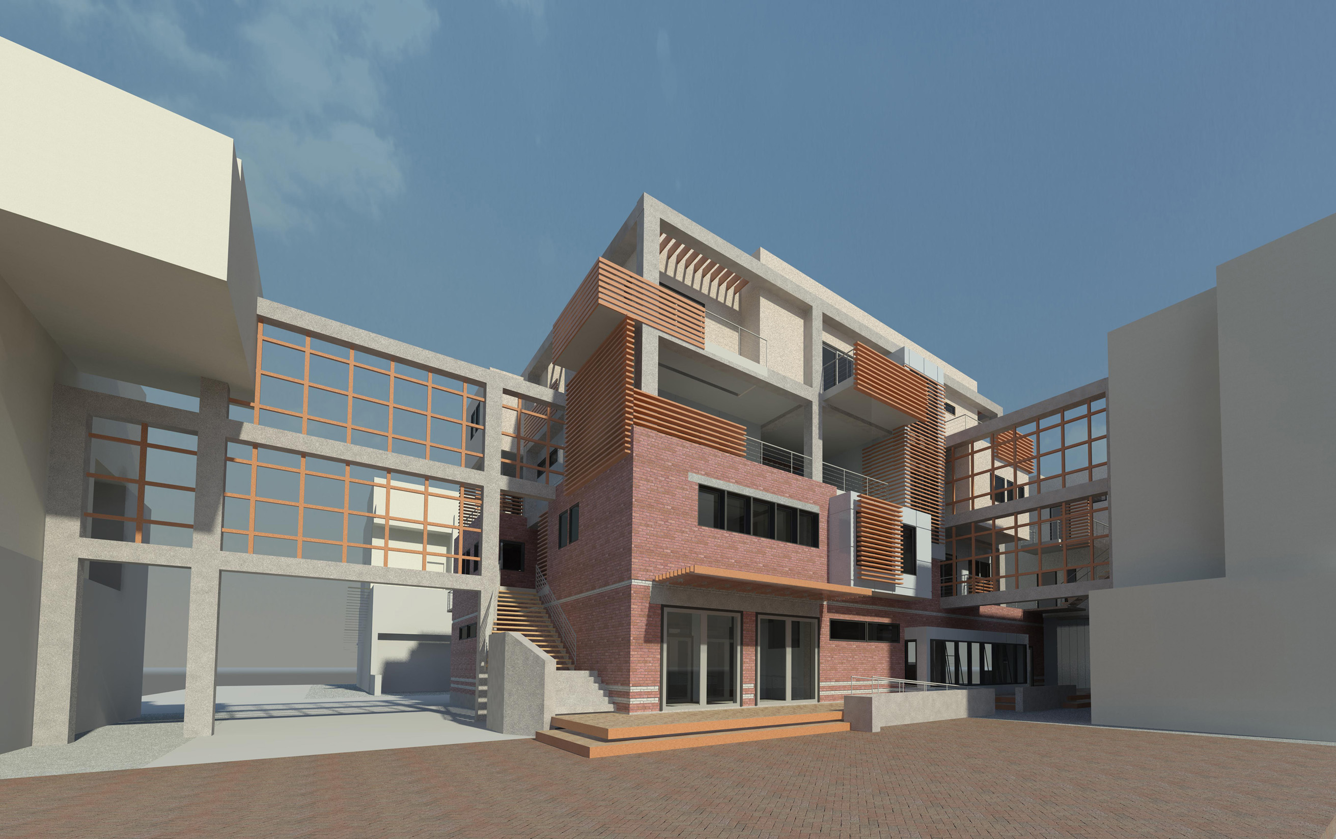

Thu, May 20, 2010 at 10:02:55 PM | result
#11
benlikespizza
Joined: Tue, Apr 13, 2010
9 Posts
plaza perspective of building, spliced region render put together in photoshop.  i would welcome any comments, tips, or questions!!
