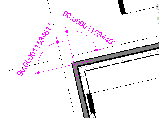

We think we worked out the cause:
Walls were not quite perpendiclar to grids, 90.00001153449° instead of 90° (see attached screen shot).
When sections are created they make themselves parallel to the nearest thing (usually a wall).Therefore sections were not exactly perpendicular to grids.
Unfortunately there is no way to align sections.So after aligning the walls to grids, we had to re-create all the sections.
Revit is very unforgiving, it will not tolerate sloppiness.
Lesson learnt: keep Rhino users away from Revit!
