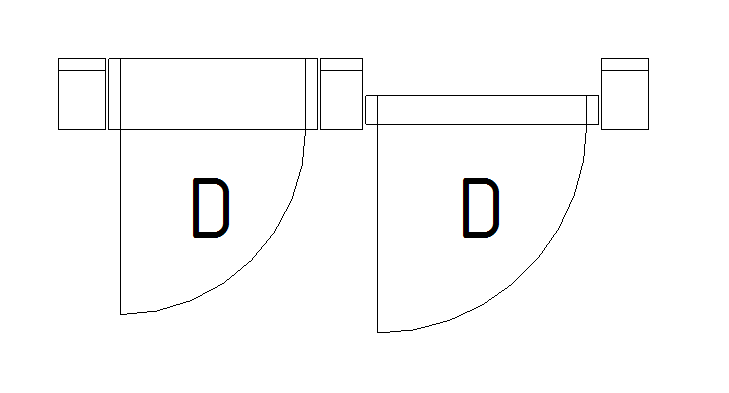

So I've been creating a custom library with parts for a template, and I've used the doors that come with Revit and made smaller changes. The issue I've got is that the "indoor-doors" auto adjusts their frame-depth to the walls depth, even if there is a "Frame-depth" dimension type. It looks kinda silly with a 300mm Door-frame. Anyone know if this is easily changed? Because the "outdoor-doors" have a settable and working door-frame depth parameter. edit: You could watch the image for an overview. (Left inner door, right outer door)

This is because this is the way the family is built. If you want the "indoor" door to have a controllable frame depth, you will have to modify it. Use the other door as an example, or use that door and modify it to create your interior doors.
