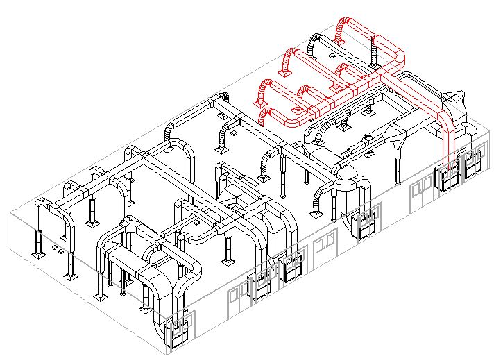

Hi,
Can anyone out there tell me if its possible to create simple 3d color diagrams to show different colors for different duct systems? i i've created supply and return systems and can't even override in view the duct colors. I'm stumped... i've attached a generic 3d view that i'd like to show the D/X units and the ductwork the same color, similar to the color schemes in plan, just in 3d.
If this is the wrong place to post this please let me know.
Thanks

I use filters in 3D, quick and easy to color. They should be set up in the Mechanical Default template...you can transfer them in your project if you are unable to add them to your view. hth.
