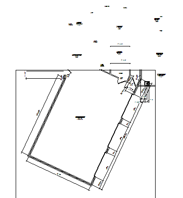

Here is an example of my problem. I have the crop region visible in the lower left hand corner and you can clearly see the wall are cropped properly, but there is a lotta text outside of the region at the upper right that I need to turn off. Does anyone know what I'm doing wrong?

The text and dimensions are view specific and as such doesn't comply with the crop region. You'll have to delete the text outside of the crop region. In most case when detailing a view you'll need to place text outside the crop region so as to not conceal the model you are trying to show...

Thanks for your help!! Got it!
