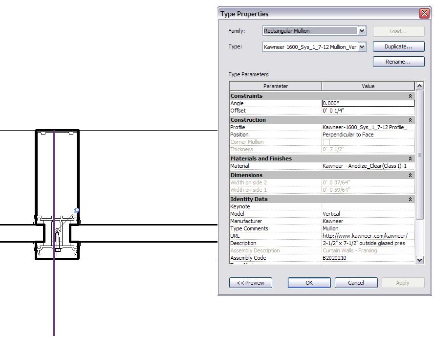

Downloaded Kawneer 1600 wall system project and noticed that the mullions aren't quite centered on the Curtain Grid. Check the composite screen shot with the Mullion Properties and the Curtain Grid selected. Thought it was a Kawneer issue, so I made my own from scratch. Same result. Has anyone else noticed this? Is it a bug in the Mullion Profile template?

Second ... If the Kawneer family was built incorectly, then shame on them.  The problem is very evident in you image and maybe something you changed somehow.  The width on side one and two are not equal, thus the mullion is not centered.

Update. It's Kawneer's faulty content. I did another simple test and the new mullion profile worked fine. I need to make a new Kawneer type mullion with detail from scratch.

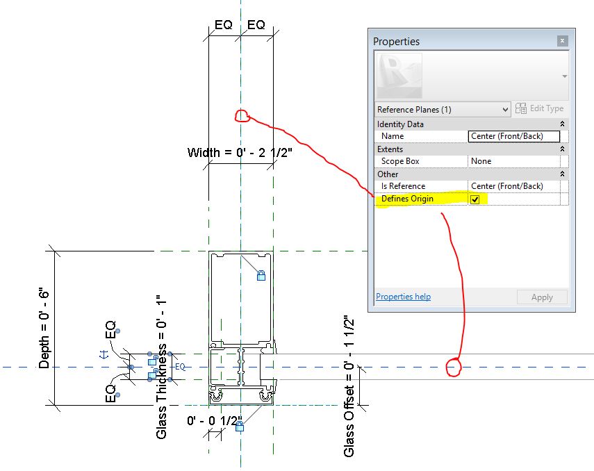

To make the Kawneer mullions center propperly you need to open the curtain mullion family from Kawneer and make sure the "Defines Origin" check box is checked for the Center (Left/Right) and Center (Front/Back) reference planes. Also make sure the nested profile family is locked to the Center (Left/Right) reference plane.

Thanks for the solution wmyers. Your a star. This has also frustrated me in the past
