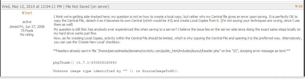

Somehow, my previous thread (http://www.revitcity.com/forums.php?action=viewthread&thread_id=20456) won't show any responses, so I'm reposting it here. WWHUB, the attached screenshot is the last I get to see, so I didn't get to read your response.

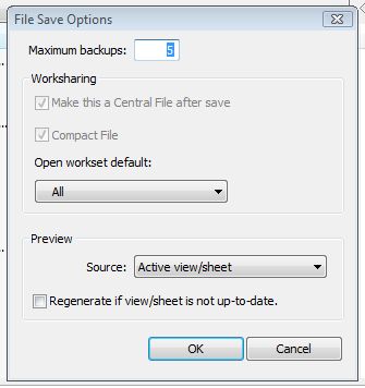

If you copy the Central file to a new location then open it via the "detach" option what you get is a file that has worksets but is not a new Central file.  You need to go through the process of saving it again and under options make sure the "make this a central file" box is checked.  The reason is becasue Revit hard codes the central file location into the .rvt file using the UNC pathing.  This is so the local copies you make know where home is.  Without the re-saving, the copies of the detached central are probably still looking to the old central file location hard coded into the .rvt file since this has not been reset.

I really did not respond.  You last post (a duplicate of the previous) bombed the thread. I was trying to delete the bad post but could not.
I'm not sure what users are doing when they do a double post like yours.  Maybe because the duplicated post had an embedded image which maybe was no longer available, the post fails but locks the thread.  As administrator, I can't even delete this post.
Please review how you are posting so that this does not happen again.

Tom,
Revit takes care of this as we detach from a Central File. This new detached file needs to be saved, and by default the saving as a Central File-option is already checked. In fact, it can't be unchecked. The file we just saved is now a Central File and any copy of it becomes a Local Copy. The extra Save As Central step is not necessary.
