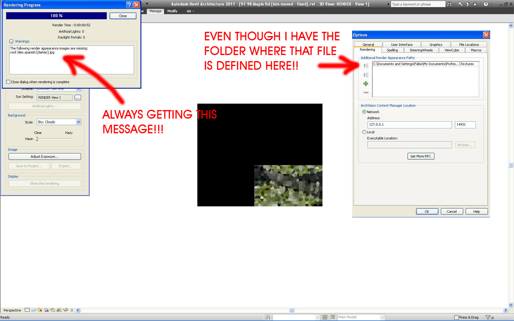

Guys, I usually copy one of the existing JPEG materials, change its color in photoshop, put the file in a separate folder and add the folder in the Options > Rendering tab > Additional Render Appearance Paths.
The problem is every time I start rendering something I get that message saying THE FOLLOWING FILES ARE MISSING at the begining of the render and I have to go material by material showing manually where the files are. What am I doing wrong?

fabioloretti
Joined: Thu, Jun 25, 2009
64 Posts
3 Stars: 2 Votes
Here is what I get EVERY TIME!!!!

Did you apply that material in a new project in 2011 OR you are render a 2010 project in Revit 2011?
Check in the Materials dialog box if that "roof.tiles.spanish.jpg" image is associated to the roof object.

Well, I probably did both wrong. The project was actually started in 2010 and upgraded to 2011.
And no, I just created the material and painted on top of the existing roof family. Tudo errado?? hehe
