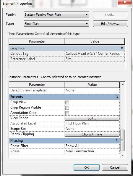

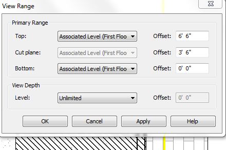

Hi I draw walls on floor plan but they are not visible. View range  window numbers are  as such in the attached file.
This settings seem to work on other projects but it does not work on thiis current project. Waht else should I  check?Walls are on in visibility graphics of floor plan. I checked Phasing settings, everything seems fine on that one as well. PLease help, I am a newbie.
 thanks
Sudanhafif

Check your wall top and base are within where you want them,Also go into your visibility/graphics override and make sure walls are ticked onand press the lightbulb on the bottom of your screen to make sure it isn't hidden in the view

if you are getting pop-up that says they are not visible, the check your base offset in the properties dialog.
