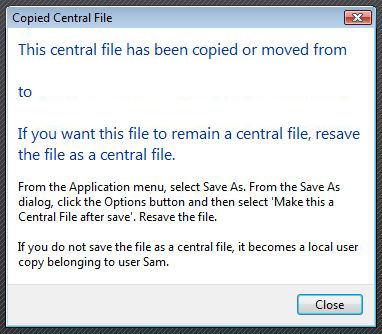

After a melt-down of our server, we had to temporarily move all of our files to a separate server untill we get a new one installed. As we've been moving files around, and relinked any modified links, we end up getting 'File Not Saved' messages and plenty of Revit crashes.
Here are the steps we've made:
1. Since we moved our Central File, it is now considered a Locoal Copy, so we have to detach it;
2. We do a Save As, and everything seems to save well; it goes up to 100%;
3. We get the 'File Not Saved' message, yet the file is located on our server, and seems to have the correct file size;
4. Since this is now a Central File, we make a copy of it and rename it. However, this Local Copy finds no connection to the Central File we just created.

We've had problems like this, and it was remedied by Auditing the Central File while opening it (simply check the "audit file" box when opening the central file.  After auditing, create new local files from the audited central file.
