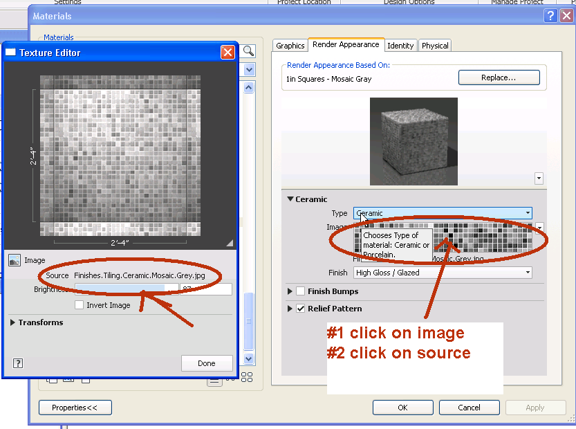

Albert I don't have Revit here to show you with an image but i think you gonna understand... after you select a material>duplicate then in Render appearence click on the image, then you can select the folder and the file (image...) of that new material you want to apply....
Tue, May 11, 2010 at 9:40:46 AM | What happen to the material properties in Revit 2011
This was a little harder to find then in 2010...look at attached image
  • This is in your HELP
  • Create a new material name by copying something close and renaming
  • Under manage / materials, replace the ender appearance using something similar to what you want
  • To use a new image file, click on the image and the texture editor comes up
  • Click on the source and it will turn color and you can search for a new image file
  • You do a similar process for the bump file if you need it.
